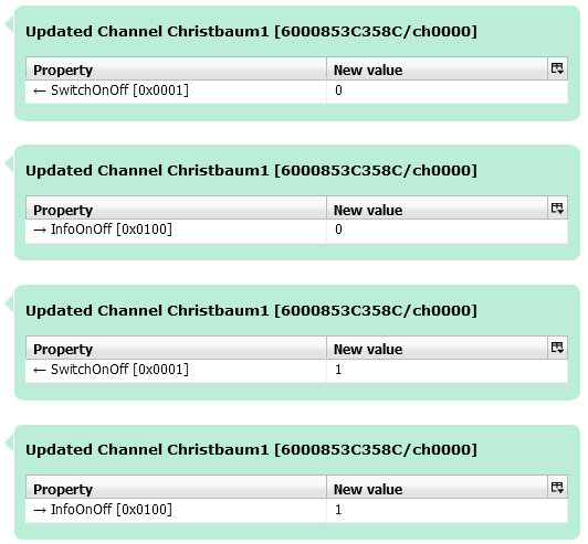

Hi Stian,
I finally got it to install your new Binding version 3.2.0 and did some tests with virtual switches without deviceEmulation. I created the virtual switch via Postman. It gots visible in SysAP and can also be detected by OH. But I faced one problem. As you wrote, it should be possible to switch the virtual switch wether from OH or from SysAP. But for me, only one way is working. When I switch it from OH, then the status is also changed in SysAP, but when I click on it in SysAP or also Panel, the status does not change at all.
When I have a look on the free@home Monitor, I can see it like below:
Switched from OH:
→ everything seems to be ok.

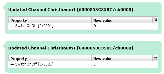

Switched from SysAP:
→ Status does not change
Is it a general problem or do I make anything wrong?
Should I gather some more logs for you?
One further info:
I already created a virtual switch long time ago. Here, deviceEmulation is enabled. And with this setting, I can switch this old virtual switch. But it looks a little different in the Monitor.
Thanks a lot in advance.
