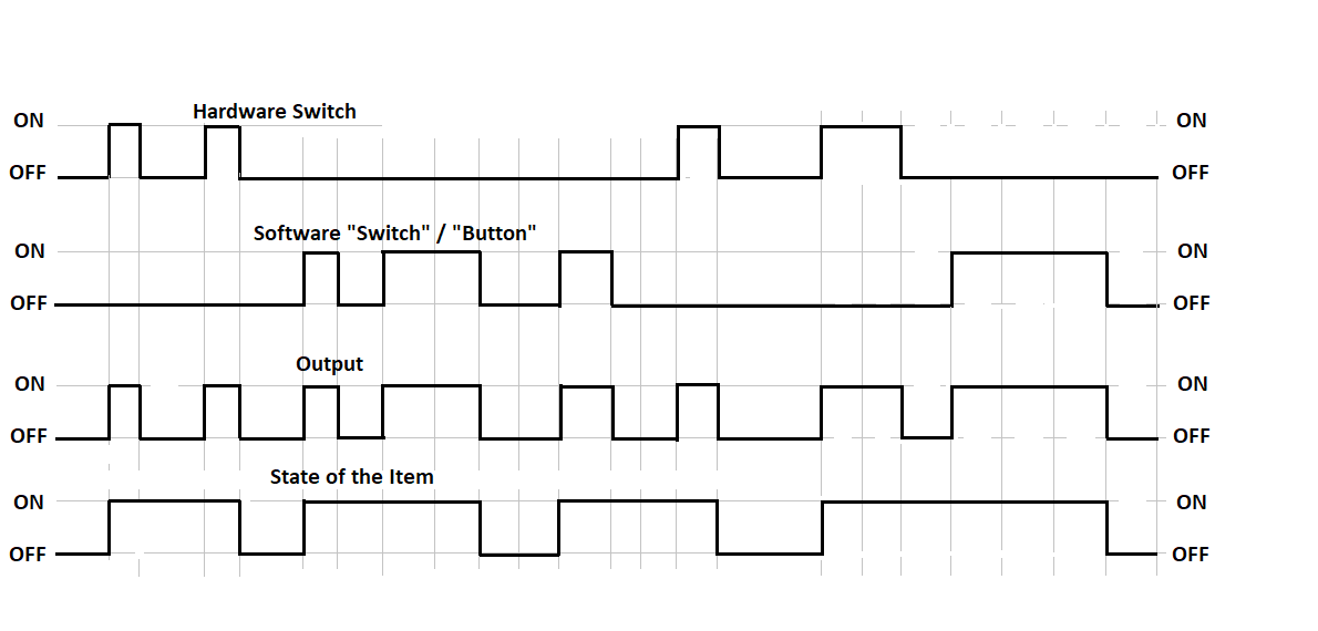

What´s my goal:
A click on the Hardware Button should change the my output as long as i stay pressed
In Openhab i want the “same” as long i Click on my “switch” (maybee i have to use different item), the “switch” should get ON.
For better understanding of my goal see the picture.
Openhabgoal
Thanks for Help

it changed nothing. only first rising edge changed to ON last falling edge changed to OFF
