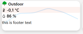

I tried to move the content to background slot and added oh-trend and now buttons works properly.
But the styling is completely different:
But I think I could solve the styling problem much easier than the not-working buttons. Will give it a try tomorrow. Thanks for the tip with background slot.
I added a block as a container for the whole background slot to control margin, color etc.

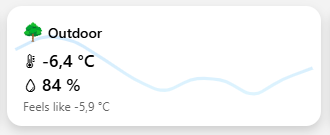

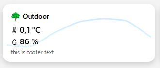

With background slot I was able to finish the widget.
Here is how the final widget code looks like, if someone is interrested:
