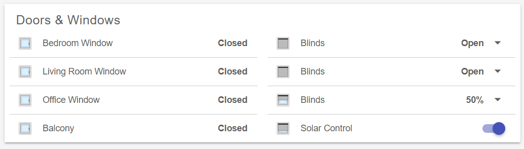

If you want an alternative solution, I use rules to move my rollershutters in specific intervals based on factors such as time of day, temperature, UV level, cloud coverage, and open/closed windows. I’ve also made the intervals available in my site map, so that I can trigger them manually.
The reason this works is that I rarely want to control them manually. My rollershutters move to the right positions based on the environmental conditions, without me having to think about them at all.
Some folks go even further, having their rollershutters constantly adjust throughout the day based on the position of the sun. That’s more than I need, but I love that it’s possible.
