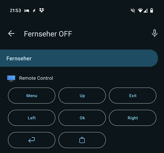

So its finally working but i have some trouble with the icons in the buttongrid.
Only f7 icons without “_” are displaying, I tried several options.
What am I missing?
Example in sitemap:
Buttongrid label="Remote Control" staticIcon=screen item=GoogleTV_KEYPRESS buttons=[1:1:MENU="Menu" , 1:3:EXIT="Exit" , 1:2:UP="Up"=f7:arrowtriangle_up , 2:1:LEFT="Left"="f7:arrowtriangle_left_circle" , 2:3:RIGHT="Right"=f7:arrowtriangle_right , 2:2:OK="Ok", 3:1:RETURN="RETURN"=f7:return, 3:2:DOWN="Down"=f7:bag
This is what i get:
again its working on the browser so i guess its another bug. Just would love some simple arrow icons

Can you try f7:arrowtriangle-up? I’m not sure yet what’s the expected behavior here. Where did you see the underscore in the icon name?

I thought underscores were a workaround to differentiate against the icon state in classic icons. The actual icon names use hyphens

Awesome, thanks. Its working with “-”
I found the underscore in the official f7 documentation as well in the openhab documentation: Sitemaps | openHAB
jimtng
(jimtng)
February 22, 2024, 5:33am
12
Thanks for bringing this up. I think it should be underscore, but the android app uses iconify to display f7 icons, and in the iconify world, the underscores were changed to dashes.
I’ve submitted a fix for this Translate f7 underscores into iconify style dashes by jimtng · Pull Request #3603 · openhab/openhab-android · GitHub
Until that PR is merged and your app is updated, you should change your icon:
from: f7:arrowtriangle-right to: iconify:f7:arrowtriangle-right
This will ensure that your buttongrid icons will also show up correctly on the web browser.
Once the PR is merged, you could go back to using the correct f7:arrowtriangle_right (with underscore) or leave it as iconify:f7:arrowtriangle-right
