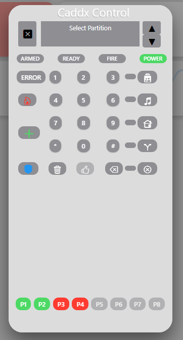

Caddx Binding Widget
Alarm Control Binding based on the CADDX Binding
Caddx Widget V6c
Makes use of:
UI Widget: Keypad by Yannick Schaus. Used for the Keypad functionality and was the starting point for the entire project
[OH3 Harmony Widget] () by Craig B. Used for the GUI basis. Used to get the basics of the graphical front end.
Tried to keep the graphics of the widget as similar as I am capable of to the look of the NX-148e keypad. Though had to make some exceptions for functionality.
Received extensive help on the forum with ideas, syntax etc.
The Widget is made up of the Main Graphical Front End (laid out to fit an Android Phone in Portrait Mode), with two additional Widgets to format the Bypass Zones and Faulted Zones display popups. The widget also relies on an underlying set of rules to send actions to the binding etc. The rules in my setup are TEXT based, however these could be recreated into the UI if required I beleive (easier to share this way too).
The two display widgets could be replaced with a “actionGroupPopupItem” action. However I did not like the display and there do not seem to be any options for formatting the display at all.
The Widget Offers the following settings via the Widget Props:
Partiton Selection Proxy Item - this is a proxy STRING item used to process the Partiton Selection to allow the switching between Partitons within the Widget.
Alarm Feedback Item - used to provide feedback from rules etc in the widget. This item should have the Expire Metadata set to a suitable time with the “Update State” to set state to “-”.
Show Tooltips in Widget - enable or disable Tootips when the widget is running. Nice to have when starting and an easy place to give details, but not required for daily operation.
Mask Character - as per the original Keypad, just a character to mask the CHaracters being entered.
In order to make use of the PROPS, there is a requirement for a standard name convention. I used PartitonX_. There are groups that must comply to this as well. Difficult to list all of them, however a staring point would be:

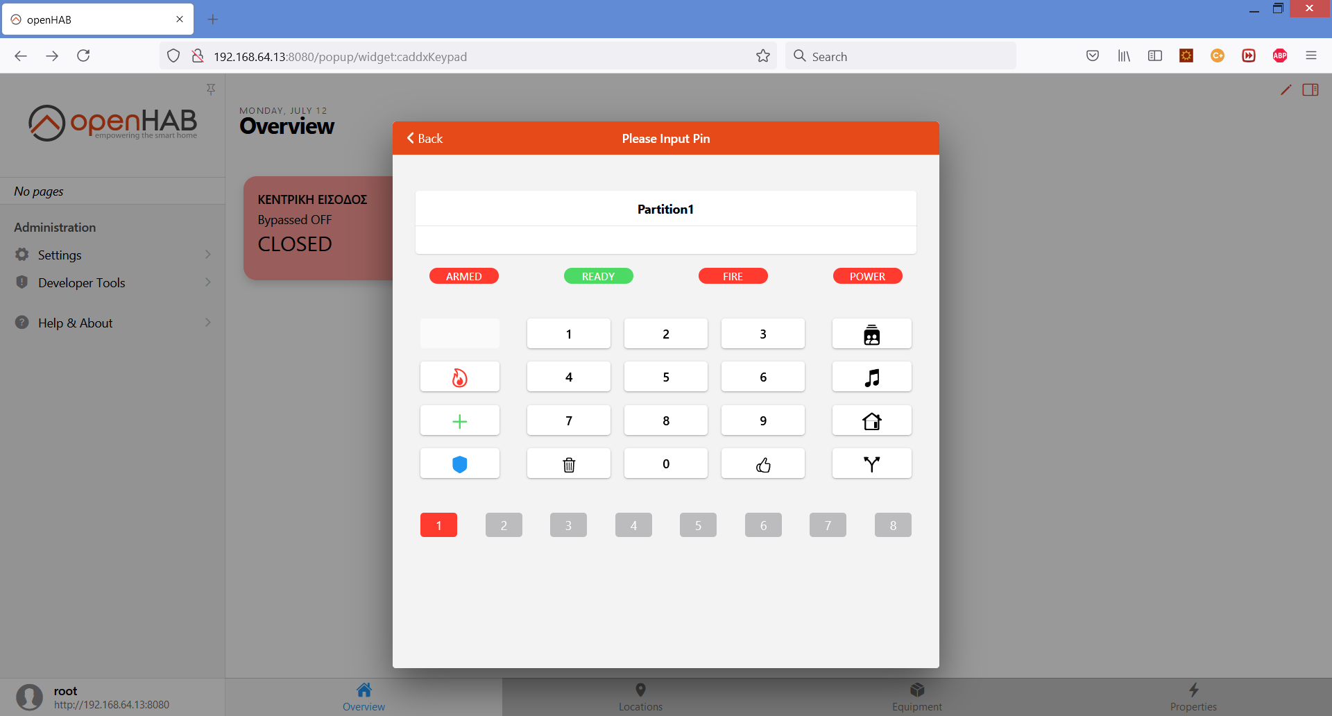

EDIT: Forgot to include .rules file - you will need to replace with your Bridge ID.
Partition1.txt (3.1 KB)
EDIT: Fixed error on ARMED and BYPASS buttons - not using vars for Partiton Selection. Code replaced
EDIT 06/05/2021 Added V2:
caddx_graphic_portrait_V2.txt (26.5 KB)
EDIT 13/07/2021 Added V5:
caddx_graphic_portrait_V5.txt (33.2 KB)
Uses % for layout
Built in Logs, Bypass Zones, Faulted Zones - Toggle with READY, BYPASS and DOWN_ARROW
Only external items is the Feedback item.
EDIT 22/07/2021 Added V6
caddx_graphic_portrait_V6.txt (28.1 KB)
Made some enhancements based on the suggestions by @jossuar . Fully self contained now - no external rules required

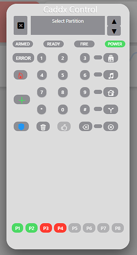

EDIT 16/12/2022 Added V6c
Sadly my Caddx system has failed so I will be replacing and no longer making changes to this widget. Hopefully it helps someone out there.
Will be changing to a Paradox EVO setup and have started a similar widget. Binding does not look as complete however, so going to miss by Caddx.
Changelog
Version 6c
Make the widget self contained with no external rules requirements, Added Fixed Popup Size

    - component: oh-button
        action: variable
        actionVariable: pincode
        actionVariableValue: "=(vars.pincode) ? vars.pincode + '3' : '3'"
        bgColor: gray
        large: false
        raised: true
        style:
          border-radius: 12px
          left: 60%
          position: absolute
          top: 20%
        text: "3"
        textColor: white
    - component: f7-badge
        bgColor: '=(items[vars.selectedPartitionC + "_EntryGuard"].state === "ON") ? "green" : "gray"'
        style:
          border-radius: 12px
          height: 12px
          left: 71%
          position: absolute
          top: 21%
          width: 25px
        text: StayLED
        action: command
        actionCommand: '="partition_secondary_command|0," + (1 << (((vars.selectedPartitionC === NULL) ? props.selectedPartitionC : vars.selectedPartitionC).substr(-1) - 1))'
        actionItem: =props.sendCommand
        bgColor: gray
        iconF7: person_2_square_stack_fill
        iconSize: 20
        style:
          border-radius: 12px
          left: 79%
          position: absolute
          top: 20%
          width: 12%
        textColor: white
        tooltip: '=!(props.tooltipEnable) ? false : "Arm in STAY Mode"'
        tooltip-trigger: hover
        action: command
        actionCommand: ="partition_secondary_command|4,1"
        bgColor: gray
        iconColor: red
        iconF7: flame
        iconSize: 20
        style:
          border-radius: 12px
          color: white
          left: 6%
          position: absolute
          top: 27%
        tooltip: '=!(props.tooltipEnable) ? false : "Fire Panic"'
        action: variable
        actionVariableValue: "=(vars.pincode) ? vars.pincode + '4' : '4'"
        bgColor: gray
        large: false
        raised: true
        style:
          border-radius: 12px
          left: 25%
          position: absolute
          top: 27%
        text: "4"
        textColor: white
        action: variable
        actionVariableValue: "=(vars.pincode) ? vars.pincode + '5' : '5'"
        bgColor: gray
        large: false
        raised: true
        style:
          border-radius: 12px
          left: 42%
          position: absolute
          top: 27%
        text: "5"
        textColor: white
        action: variable
        actionVariableValue: "=(vars.pincode) ? vars.pincode + '6' : '6'"
        bgColor: gray
        large: false
        raised: true
        style:
          border-radius: 12px
          left: 60%
          position: absolute
          top: 27%
        text: "6"
        textColor: white
        bgColor: '=(items[vars.selectedPartitionC + "_ChimeModeOn"].state === "ON") ? "green" : "gray"'
        style:
          border-radius: 12px
          height: 12px
          left: 71%
          position: absolute
          top: 28%
          width: 25px
        text: ChimeLED
        action: command
        actionCommand: '="partition_secondary_command|1," + (1 << (((vars.selectedPartitionC === NULL) ? props.selectedPartitionC : vars.selectedPartitionC).substr(-1) - 1))'
        bgColor: gray
        iconF7: music_note_2
        iconSize: 20
        style:
          border-radius: 12px
          left: 79%
          position: absolute
          top: 27%
          width: 12%
        textColor: white
        tooltip: '=!(props.tooltipEnable) ? false : "Toggle CHIME Mode"'
        action: command
        actionCommand: ="partition_secondary_command|5,1"
        bgColor: gray
        iconColor: green
        iconF7: plus
        iconSize: 28
        style:
          border-radius: 12px
          color: white
          left: 6%
          position: absolute
          top: 37%
        tooltip: '=!(props.tooltipEnable) ? false : "Medical Panic"'
        action: variable
        actionVariableValue: "=(vars.pincode) ? vars.pincode + '7' : '7'"
        bgColor: gray
        large: false
        raised: true
        style:
          border-radius: 12px
          left: 25%
          position: absolute
          top: 34%
        text: "7"
        textColor: white
        action: variable
        actionVariableValue: "=(vars.pincode) ? vars.pincode + '8' : '8'"
        bgColor: gray
        large: false
        raised: true
        style:
          border-radius: 12px
          left: 42%
          position: absolute
          top: 34%
        text: "8"
        textColor: white
        action: variable
        actionVariableValue: "=(vars.pincode) ? vars.pincode + '9' : '9'"
        bgColor: gray
        large: false
        raised: true
        style:
          border-radius: 12px
          left: 60%
          position: absolute
          top: 34%
        text: "9"
        textColor: white
        bgColor: '=(items[vars.selectedPartitionC + "_Exit1"].state === "ON") ? "green" : "gray"'
        style:
          border-radius: 12px
          height: 12px
          left: 71%
          position: absolute
          top: 35%
          width: 25px
        text: ExitLED
        action: command
        actionCommand: '="partition_secondary_command|2," + (1 << (((vars.selectedPartitionC === NULL) ? props.selectedPartitionC : vars.selectedPartitionC).substr(-1) - 1))'
        bgColor: gray
        iconF7: house_alt
        iconSize: 20
        style:
          border-radius: 12px
          left: 79%
          position: absolute
          top: 34%
          width: 12%
        textColor: white
        tooltip: '=!(props.tooltipEnable) ? false : "Arm in EXIT Mode"'
        bgColor: gray
        large: false
        raised: true
        style:
          border-radius: 12px
          left: 25%
          position: absolute
          top: 41%
        text: "*"
        textColor: white
        tooltip: '=!(props.tooltipEnable) ? false : "Not yet Active"'
        action: variable
        actionVariableValue: "=(vars.pincode) ? vars.pincode + '0' : '0'"
        bgColor: gray
        large: false
        raised: true
        style:
          border-radius: 12px
          left: 42%
          position: absolute
          top: 41%
        text: "0"
        textColor: white
        bgColor: gray
        large: false
        raised: true
        style:
          border-radius: 12px
          left: 60%
          position: absolute
          top: 41%
        text: "#"
        textColor: white
        bgColor: '=(items[vars.selectedPartitionC + "_Bypass_Group"].state === "ON") ? "green" : "gray"'
        style:
          border-radius: 12px
          height: 12px
          left: 71%
          position: absolute
          top: 42%
          width: 25px
        text: BypassLED
        action: variable
        actionVariable: Bypass
        actionVariableValue: '=(vars.Bypass == "null") ? true : !(vars.Bypass)'
        bgColor: gray
        iconF7: arrow_branch
        iconSize: 20
        style:
          border-radius: 12px
          left: 79%
          position: absolute
          top: 41%
          width: 12%
        textColor: white
        tooltip: '=!(props.tooltipEnable) ? false : "Allow Zone Bypass via Popup"'
        action: command
        actionCommand: ="partition_secondary_command|6,1"
        bgColor: gray
        iconColor: blue
        iconF7: shield_fill
        iconSize: 24
        style:
          border-radius: 12px
          color: white
          left: 6%
          position: absolute
          top: 48%
        tooltip: '=!(props.tooltipEnable) ? false : "Police Panic"'
        action: variable
        actionVariableValue: ""
        bgColor: gray
        iconColor: white
        iconF7: trash
        iconSize: 19
        style:
          border-radius: 12px
          color: white
          left: 24.5%
          position: absolute
          top: 48%
        action: command
        actionCommand: '="partition_primary_command_with_pin|0x" + (vars.pincode).substr(1,1) + (vars.pincode).substr(0,1) + ",0x" + (vars.pincode).substr(3,1) + (vars.pincode).substr(2,1) + ",0x" + (vars.pincode+"00").substr(4,1) + (vars.pincode+"00").substr(4,1) + "," + ((items[((vars.selectedPartition === NULL) ? props.selectedPartition : vars.selectedPartition) + "_Armed"].state === "ON") ? "1" : "2") + "," + (1 << (((vars.selectedPartition === NULL) ? props.selectedPartition : vars.selectedPartition).substr(-1) - 1))'
        bgColor: gray
        clearVariable: pincode
        closePopup: =props.closePopup
        disabled: =!vars.pincode
        iconColor: white
        iconF7: hand_thumbsup
        iconSize: 19
        style:
          border-radius: 12px
          color: white
          left: 41.5%
          position: absolute
          top: 48%
        action: variable
        actionVariableValue: '=(vars.pincode) ? vars.pincode.substring(0, vars.pincode.length - 1) : ""'
        bgColor: gray
        iconColor: white
        iconF7: delete_left
        iconSize: 19
        style:
          border-radius: 12px
          color: white
          left: 59%
          position: absolute
          top: 48%
        bgColor: '=(items[vars.selectedPartitionC + "_Cancel"].state === "ON") ? "green" : "gray"'
        style:
          border-radius: 12px
          height: 12px
          left: 71%
          position: absolute
          top: 49%
          width: 25px
        text: CancelLED
        action: command
        actionCommand: ON
        actionItem: =(vars.selectedPartitionC) + '_Cancel'
        bgColor: gray
        iconF7: xmark_circle
        iconSize: 19
        style:
          border-radius: 12px
          left: 79%
          position: absolute
          top: 48%
          width: 12%
        textColor: white
    - component: f7-list
        class:
          - padding-bottom
        style:
          --f7-list-border-color: transparent
          background: rgb(235, 232, 232)
          left: 20%
          opacity: 80%
          position: absolute
          top: 16%
          width: 60%
        visible: =(vars.Faulted) == true
        default:
          - component: Label
              style:
                background: rgb(191, 189, 189)
                font-size: 75%
                font-weight: 500
                line-height: 20px
                padding-left: 20px
              text: Zones Faulted
          - component: oh-repeater
              for: item
              fragment: true
              groupItem: =(vars.selectedPartitionC) + '_Zones'
              sourceType: itemsInGroup
              default:
                - component: oh-list-item
                    color: '=(items[loop.item.name].state == "ON") ? "red" : "gray"'
                    item: =loop.item.name
                    style:
                      --f7-list-item-border-color: transparent
                      --f7-list-item-min-height: 14px
                      --f7-list-item-padding-vertical: 1px
                      backgroundColor: rgb(235, 232, 232)
                      font-size: 70%
                    title: =loop.item.label
                    visible: =items[loop.item.name].state == "OPEN"
        class:
          - padding-bottom
          - big-toggles
        style:
          left: 20%
          opacity: 80%
          position: absolute
          top: 16%
          width: 60%
        visible: =(vars.Bypass) == true
        default:
          - component: Label
              style:
                backgroundColor: rgb(191, 189, 189)
                font-size: 75%
                font-weight: 500
                line-height: 20px
                padding-left: 20px
              text: Zones Bypassed
              for: item
              fragment: true
              groupItem: =(vars.selectedPartitionC) + '_Bypass_Group'
              default:
                - component: oh-toggle-item
                    color: '=(items[loop.item.name].state == "ON") ? "green" : "gray"'
                    style:
                      --f7-toggle-height: 10px
                      --f7-toggle-width: 35px
                      font-size: 70%
        class:
          - padding-bottom
        noChevron: false
        style:
          left: 20%
          opacity: 80%
          position: absolute
          top: 16%
          width: 60%
        visible: =(vars.showLogs) == true
        default:
          - component: Label
              style:
                font-size: 80%
                font-weight: 500
                line-height: 150%
                padding-left: 1%
              text: Alarm Logs
          - component: f7-list-item
              accordionItem: true
              style:
                --f7-list-item-padding-horizontal: 10px
                --f7-list-item-title-line-height: 100%
                color: black
                font-size: 75%
              title: =items.Panel_LogMessage10.state
              default:
                - component: f7-accordion-content
                    default:
                          style:
                            font-size: 75%
                            z-index: 1
                          title: =items.Panel_LogMessage9.state
                          style:
                            font-size: 75%
                          title: =items.Panel_LogMessage8.state
                          style:
                            font-size: 75%
                          title: =items.Panel_LogMessage7.state
                          style:
                            font-size: 75%
                          title: =items.Panel_LogMessage6.state
                          style:
                            font-size: 75%
                          title: =items.Panel_LogMessage5.state
                          style:
                            font-size: 75%
                          title: =items.Panel_LogMessage4.state
                          style:
                            font-size: 75%
                          title: =items.Panel_LogMessage3.state
                          style:
                            font-size: 75%
                          title: =items.Panel_LogMessage2.state
                          style:
                            font-size: 75%
                          title: =items.Panel_LogMessage1.state
    - component: f7-block
        class:
          - padding
        style:
          --f7-button-bg-color: var(--f7-card-bg-color)
          --f7-button-text-color: var(--f7-text-color)
          --f7-theme-color-rgb: var(--f7-color-blue-rgb)
          position: absolute
          top: 85%
          width: 100%
          z-index: 999
        default:
          - component: f7-row
              class: no-gap
              style:
                --f7-button-bg-color: transparent
                --f7-theme-color: var(--f7-color-blue)
              default:
                    for: partition
                    fragment: true
                    in:
                      - 1
                      - 2
                      - 3
                      - 4
                      - 5
                      - 6
                      - 7
                      - 8
                    default:
                      - component: f7-row
                          width: "10"
                          default:
                                action: variable
                                actionVariable: selectedPartitionC
                                actionVariableValue: ='Partition' + loop.partition
                                bgColor: '=(items["Partition" + loop.partition + "_Armed"].state === "-") ? "gray" : (items["Partition" + loop.partition + "_Armed"].state === "ON") ? "red" : "green"'
                                disabled: '=(items["Partition" + loop.partition + "_Armed"].state === "-") ? true : false'
                                fill: true
                                raised: false
                                style:
                                  --f7-button-hover-bg-color: var(--f7-color-blue-tint)
                                  --f7-button-pressed-bg-color: var(--f7-color-blue-tint)
                                  border-radius: 12px
                                  overflow: hidden
                                  text-overflow: ellipsis
                                  white-space: nowrap
                                  z-index: 999
                                text: =["P" + loop.partition]
                                textColor: white
                                tooltip: '=!(props.tooltipEnable) ? false : "Apply Partition to current run"'
Called as a POPUP from an oh-cell as follows:
component: oh-cell
  title: Alarm
  background:
        bgColor: none
        style:
          height: 40%
          left: 0%
          position: absolute
          top: 60%
          width: 100%
        default:
              popupOpen: .caddx-pop
              style:
                height: 100%
                width: 100%
              text: OPEN
    - component: f7-popup
        class: caddx-pop
        style:
          background-color: rgb(220,220,220)
          border-radius: 30px
          height: 720px
          width: 360px
        default:
          - component: widget:caddx_graphic_portrait_V6c
              alarmFeedback: Alarm_Feedback
              popupClose: .caddx-pop
              selectedPartition: =["Partition1"]
              sendCommand: CaddxBridge_SendCommand
              tooltipEnable: true
  header:
        mediaList: true
        default:
              title: Alarm
              title:
                - component: f7-chip
                    color: '=(items.Partition1_Armed.state === "ON") ? "red" : "green"'
                    text: 1
                    color: '=(items.Partition2_Armed.state === "ON") ? "red" : "green"'
                    text: 2
                    color: '=(items.Partition3_Armed.state === "ON") ? "red" : "green"'
                    text: 3
                    color: '=(items.Partition4_Armed.state === "ON") ? "red" : "green"'
                    text: 4
Spacer

Hi @Mark_VG,
i did use your widget as an input and simplified it, a bit.
It does not need external rules. It only relies on the items having the default names.
It is responsive and renders correctly also on phones, etc.
It consists of the following two widgets:
caddxKeypad.txt (17.5 KB)
caddxZoneBypass.txt (1.8 KB)
Can you give it a try, to test if it works on a multi partition setup.
Hi Georgios
Gave it a try, but cannot get the alarm to disarm. Looks very good though.
I had updated to more responsive and all into one (excluding rules)
Also using variables instead of items for the pincode
Can you explain:
                                action: command
                                actionItem: CaddxBridge_SendCommand
Also, when selecting the Partition seems to light the incorrect status lights (Armed, Ready, Fire, Power)
Cheers
Mark
EDIT: I have updated my initial post above with my latest version.
EDIT: Managed to get the ARM/DISARM to work. Had to link CaddxBridge_SendCommand Still not sure about the actionCommand though? Also, the Pin does not clear .
EDIT: Looks like Item for PIN is not required in Props? Using variable
