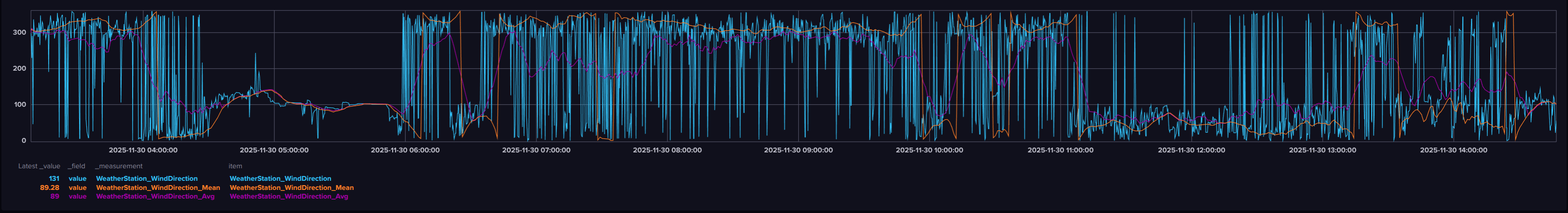

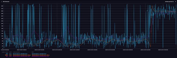

This is just a test script, which takes the wind-direction, and then calculates the result using just an average (As per my current vent rule), and also a Circular Mean, and then I have all 3 items persisted so I can analyse the results….
Or over a slightly longer interval (and less granularity):
Although for this second graph, I suspect I am comparing values averaged by Grafana, with my calculated values (5m interval, with the first graph at 5s), so it may be a bit misleading.
So, at face value, it appears to be working OK, and both calculated values track closely when the wind is predominantly from a Southern direction (180deg), and perhaps diverge as expected, when the wind direction spans either side of North.
But I only make this post, as I do still have a few doubts about the validity of the formula used - Perhaps if we get a few more days of a predominant Northerly wind, it will answer my question as well (Where the Mean stays around either side of 0/360 deg, rather than averaging to 180.
But the other part, is I am wondering if the generated formula is unnecessarily complex (given its lineage) with a much easier/cleaner way of doing it eluding me.
Any feedback welcome/appreciated, before I move this test code into my main Greenhouse vent automation script…

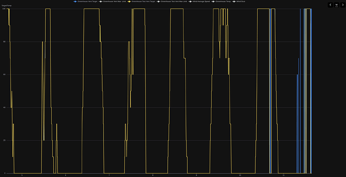

I have upgraded to 5.1 and set up a parallel test rule now, along with some test items, which I am persisting to allow me to compare the calculation to the original rule.
Now I just need some actual sun (lets not even talk about the summer holiday weather so far :frowning: ) and perhaps a bit of wind, and hopefully I should see the the test Target and Max values tracking the originals, all going to plan. Normally I would change the temp & wind targets for testing, but I don’t want to be responsible for killing the plants which are already shivering in the greenhouse :slight_smile:

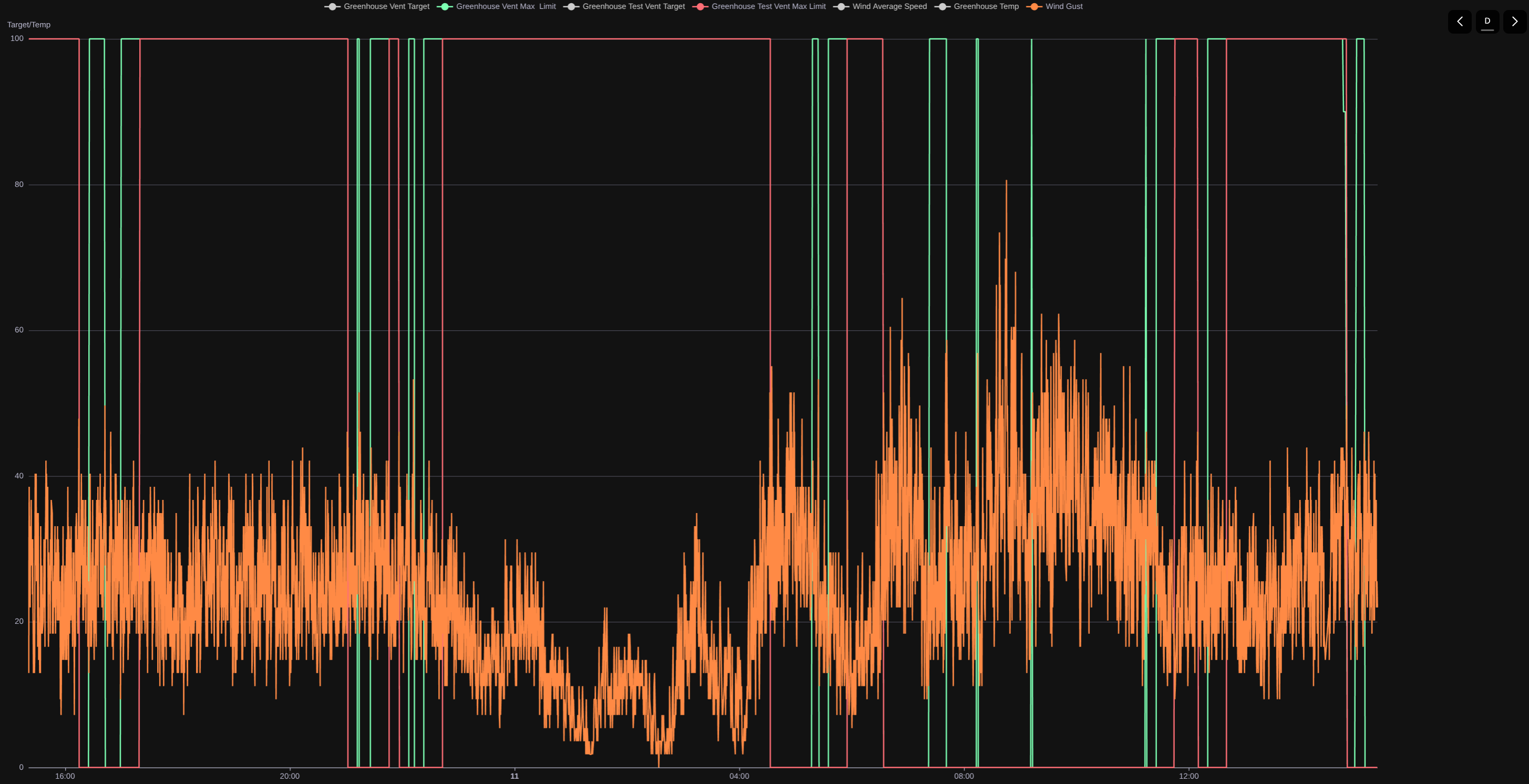

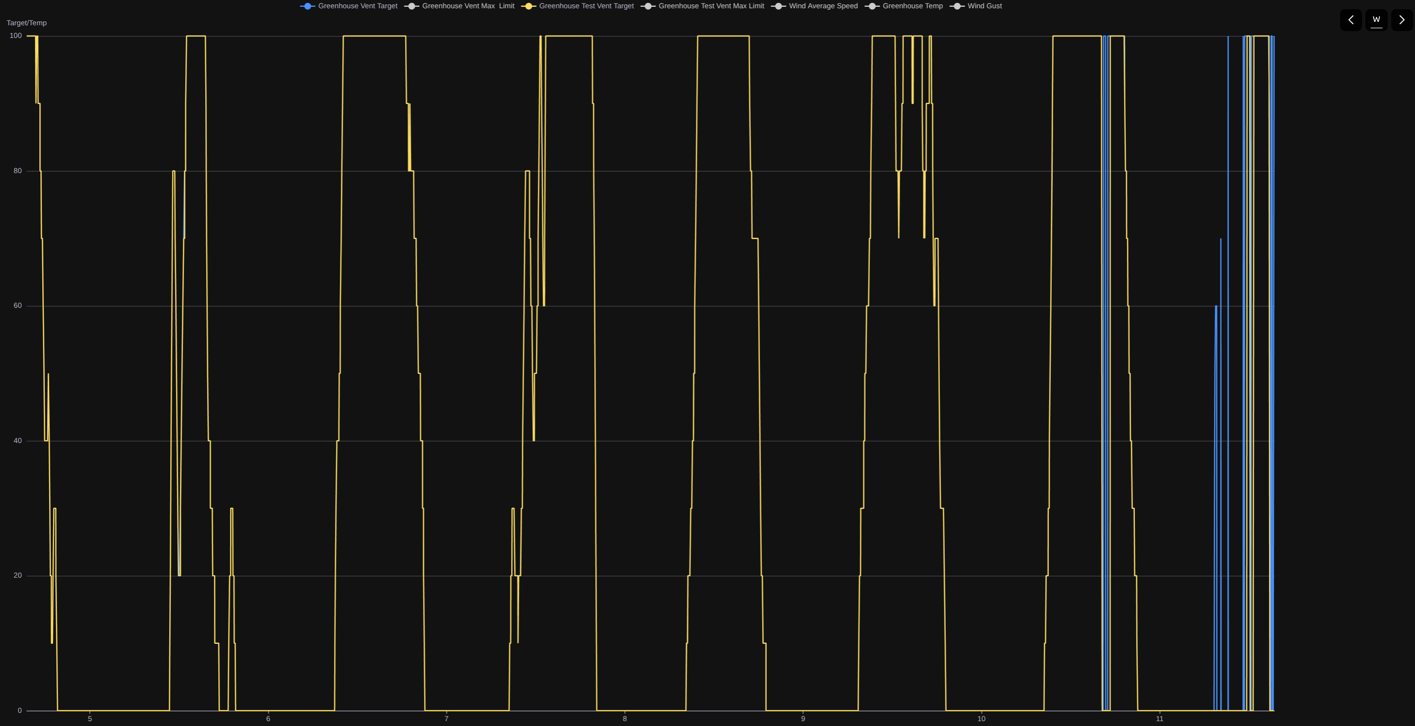

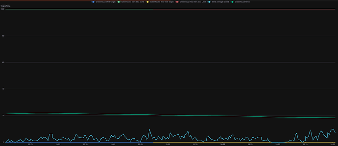

Have been running and persisting both results in parallel for a while now, and today was the perfect day with Gales and hot weather to test the vent limits, and wind direction rules.
The results over the last week seem to track really well (Until the last 12h, which I dive into below).

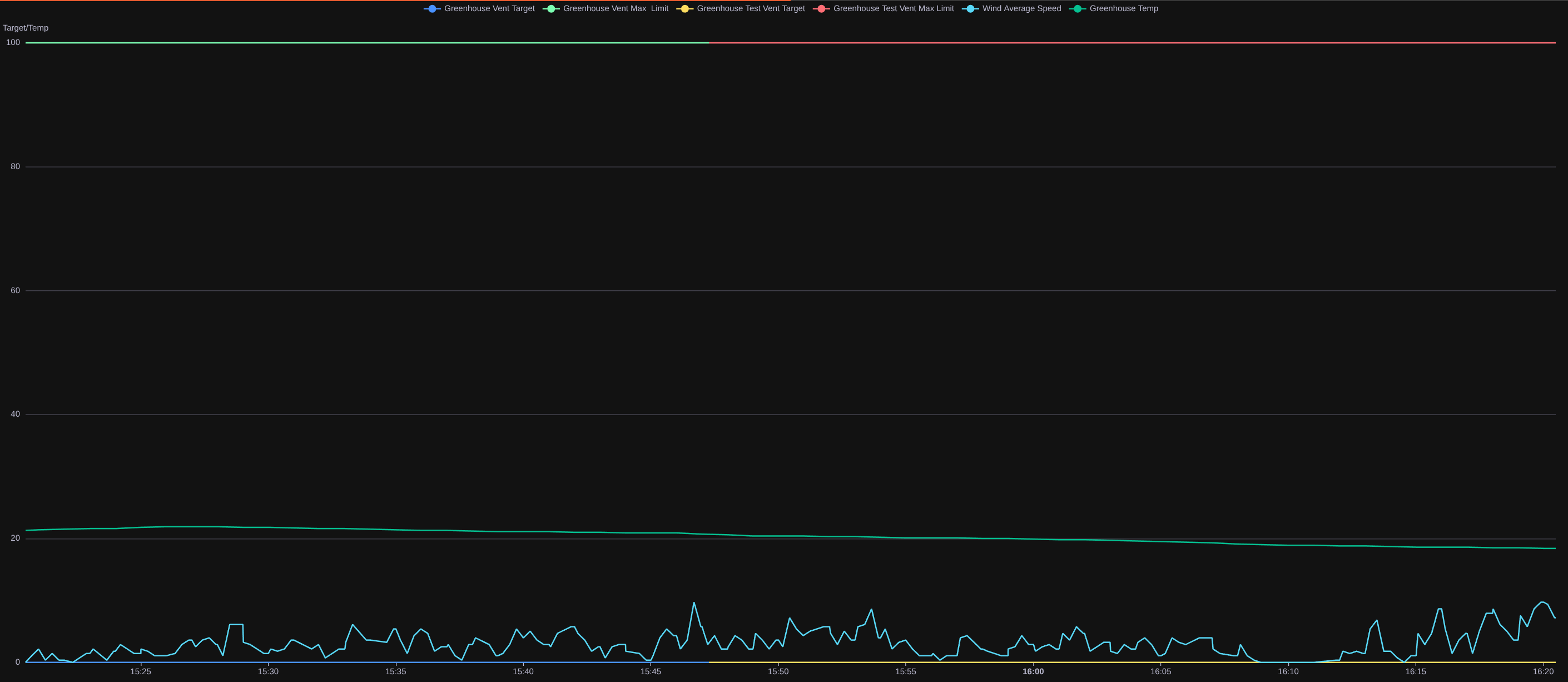

Then during the last 12 hours started to see some digression between the 2 scripts results, and was struggling to figure why the Vent Limit calculation was different between the 2:
It turned out to be a very simple thing - I had separate Interval items for temperature Average and Wind Average, used by the old script, so a quick change to the new rule (to use both Interval items) has sorted that out. Its probably not a bad thing - I preferred the Vent limit calculation in the above new scenario (More conservative post a wind gust), so have somewhat increased the wind interval item from this learning.
Final version of the script is here, just in case anyone wants to grab it to play with for their greenhouse (or similar). I will try to do a write-up this coming (Southern Hemisphere) winter, on the full project for anyone who is interested.
