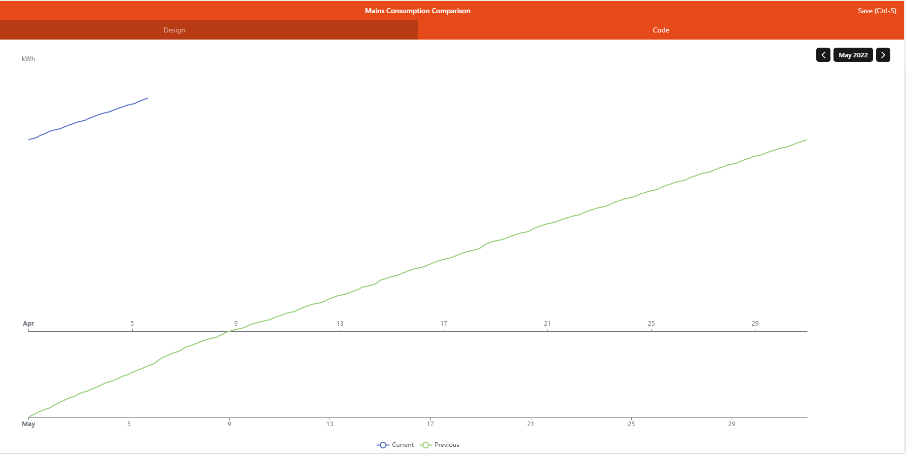

I would like to make some dynamic settings to a chart in OH3 - basically what the Y-Axix MIN value is.
This is so that the MIN value is dependent on the values being charted.

Expression results in the correct value but when I do it that way the labels don’t work?
Is there a way to convert the result back into a string? The min: value appears to have to be a string as in “10000”. Using " " doesnt seem to help

In the meantime, if your goal is just to have the axis perfectly scaled to your data, you don’ t need an expression at all. There are built-in keywords for that.
min: dataMin
max: dataMax
will automatically set the axis min and max values to the the min and max of the data.
If it’s of critical importance that you have that particular calculated axis minimum, then you can leave the expression and see if it is possible to re-engage the axis labels via the axisLabel options.
