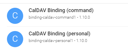

Hope can help.I’m using the binding on a “2.1.0-1 (Release Build)” openhabian installation.
I’ve installed the binding using paperUI, this is the reference:

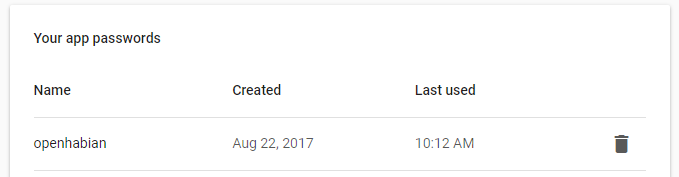

Pay attention that i’m using a google application password and not the account password in order to avoid problems with 2-factor authentication.

Last: read carefully the log because the application password is generated for a specific device and sometimes google’s security check fail to identify your openhabian as the authorized device.
