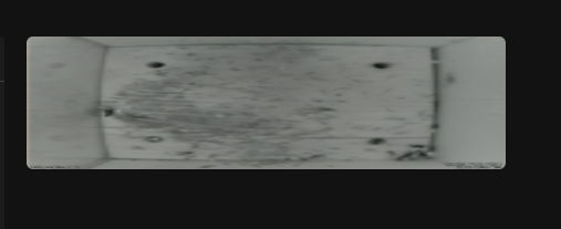

Camera: Clickable thumbnail opens to a larger stream
Updated the first post to have an improved widget that displays better across devices and now can switch an item or bring up all the controls for the camera with overlaid buttons.

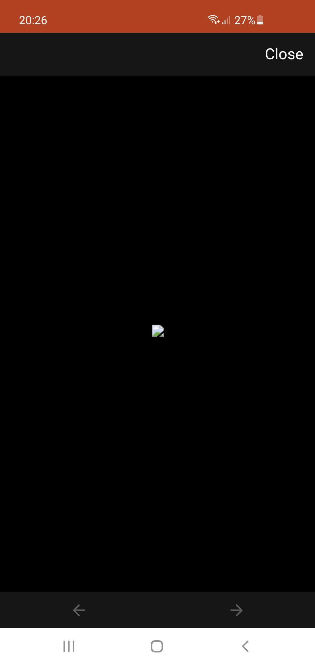

Did anyone of you tested these widgets on Android application?
I have tested it with simple mjpeg streams and it always is like below:
Tested on few streams.
EDIT:
It’s an Android app issue. In newest Beta it works better.

@kristofejro do you still have the same issue in the Android app?
Yes, it’s still present on latest release.
yes i cant get this working in the app which is a shame, all ok via a browser
