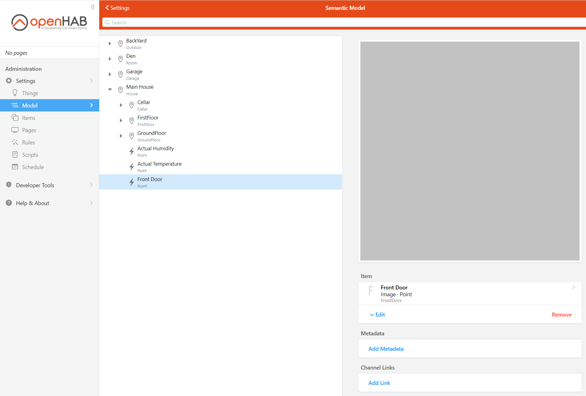

I’ve created an Item of Image Type but can’t see how you specify the path (in my case a URL from a security camera) for this Item???
The image shown is blank, and if I click on it, it points to my openhab setup at http://192.168.xxx.xxx:xxx/#!/settings/items/FrontDoor/photos/ but I want it to go to Image url=“http://192.168.xxx.xxx/api/camera/snapshot?width=1280&height=960

I’m trying to build up my Model as follows, including adding a point for the camera grab (no user/pass).

I’m trying to build it in the new OH3 GUI → Model as shown in the pic above, but for the life of me can’t work out the concept of how to add a simple picture grab.
The code I showed above is from my OH2 site where it of course just works fine with 1 line of code.
I really want to try to use the “new” method, but as some of the concepts are unfamiliar, I’m just clicking around trying to work this out.
