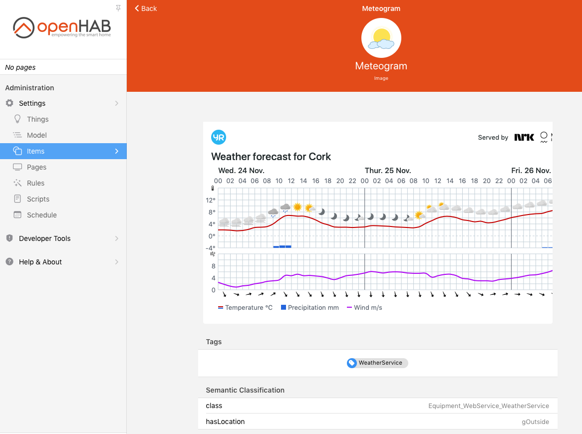

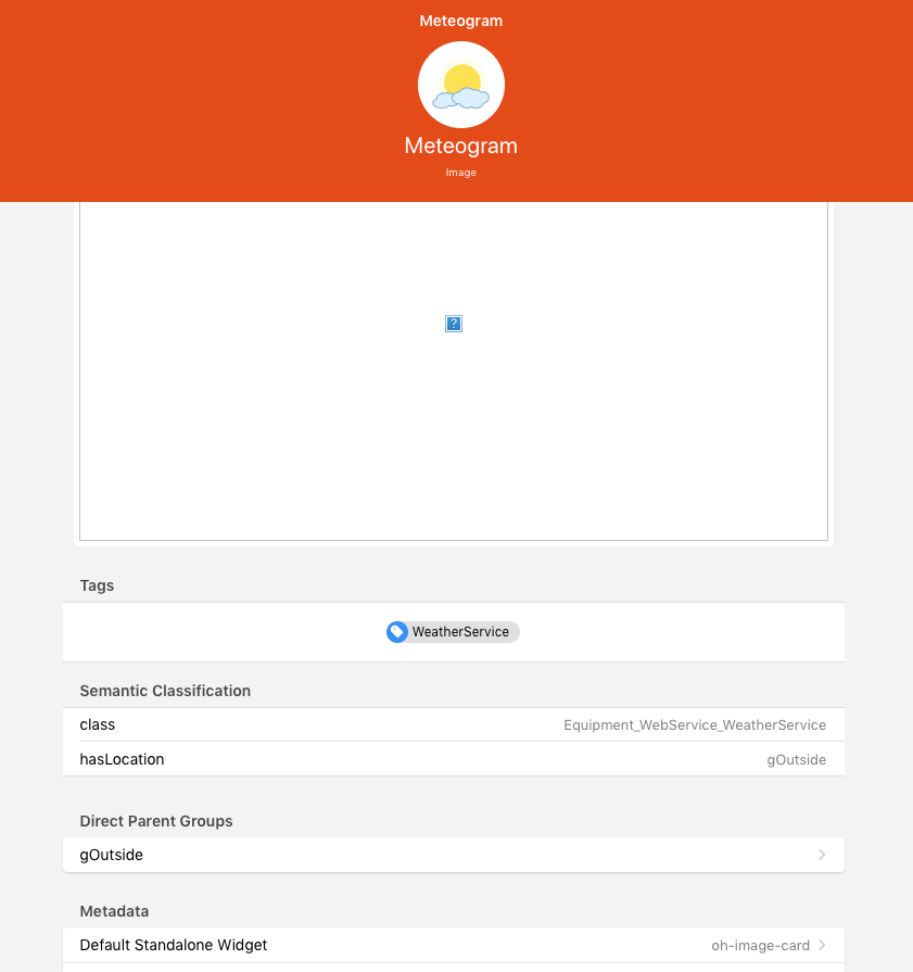

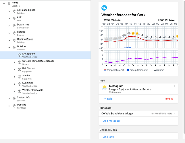

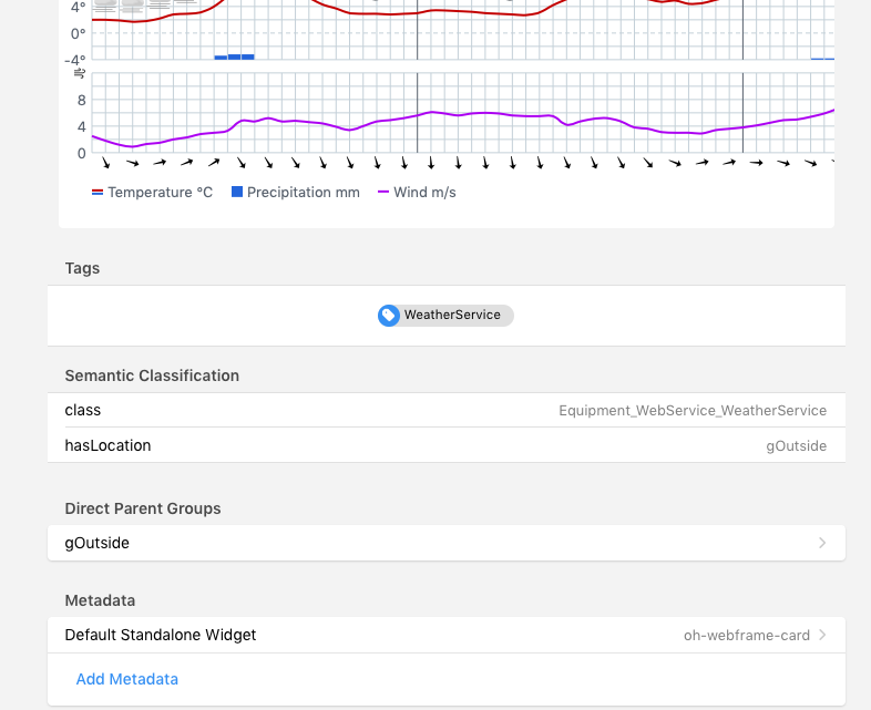

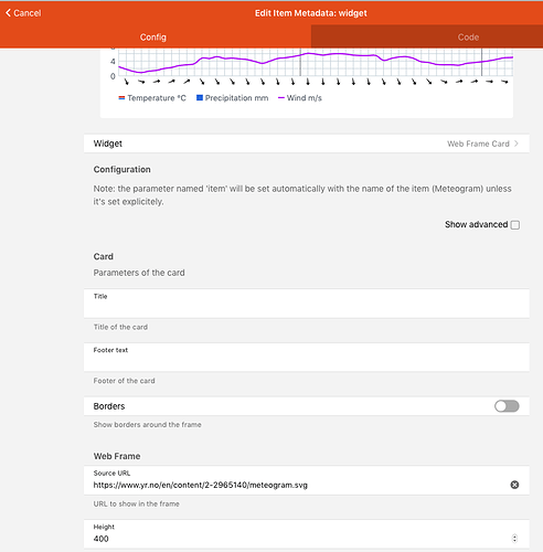

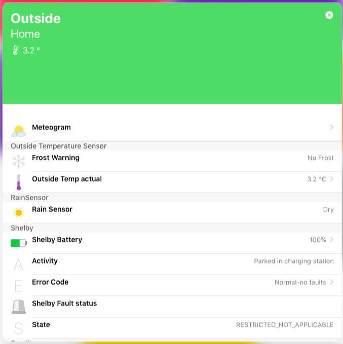

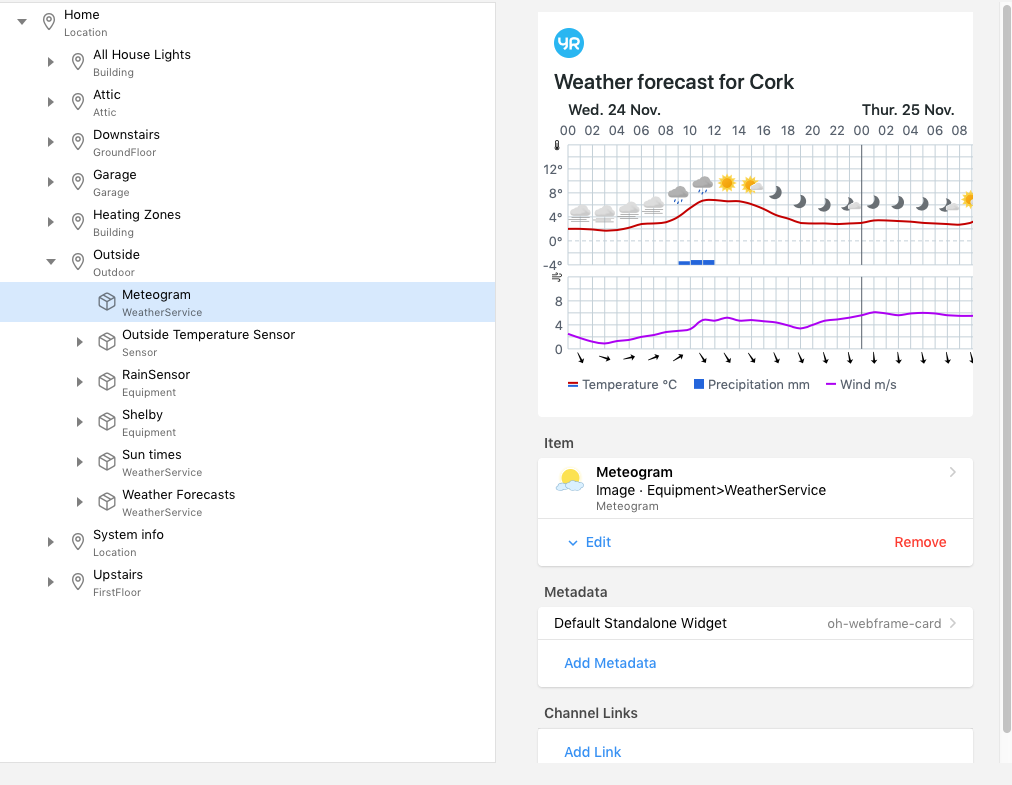

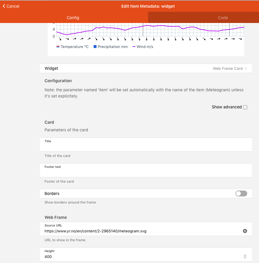

Problem: Can’t get a Meteogram weather image to display when the item is clicked from inside a UI card.
The image DOES display if I click item by drilling down via the model tree. Also it DOES display if I click the item from the items list on side bar.
Have attached screenshots which should be self explanatory. They show correct item definition & type & web frame card image widget used and location card

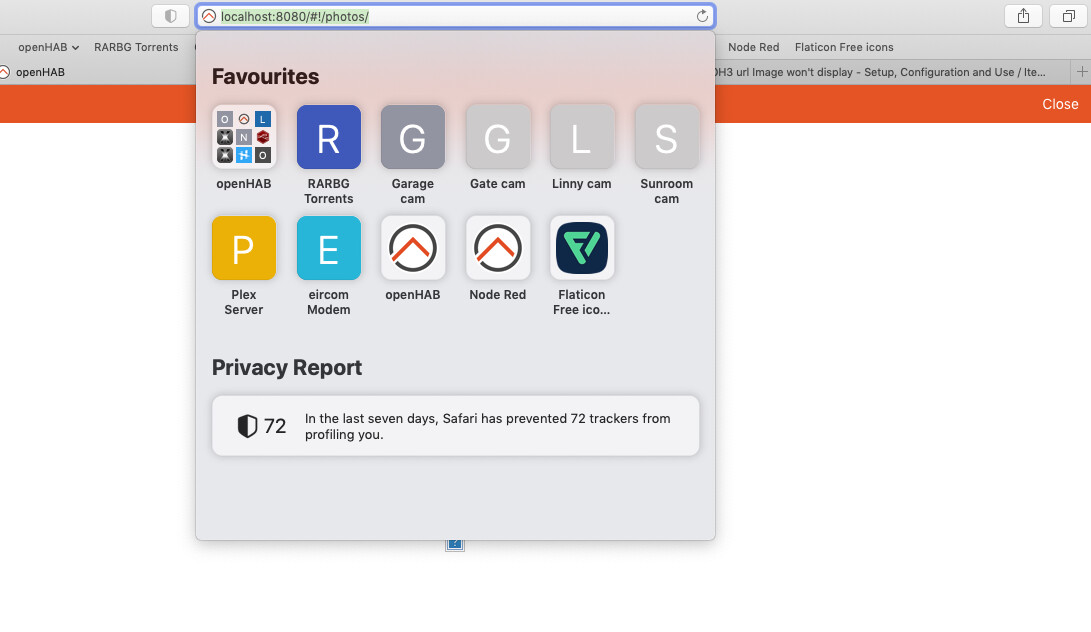

and url from Norway site filled in etc. Weird issue seems to be that when I click on the ‘meteogram’ item INSIDE THE CARD, I get a blank screen with a little box in the centre because the address bar seems to be getting filled in with a bizarre url ending of “/#!/photos/”.
It doesn’t matter whether I do this locally on the actual computer hosting OH or whether I login from another computer on same LAN. This strange ending in the target url is happening. I thought it should just go to the item which has the url and pulls the weather image? Perhaps I totally misunderstand something? All this was easy-peasy in OH2 sitemaps with an ‘image’ item and with 1 line of code.
It’s driving me nuts! Can anyone advise please? Thanks in advance.
Bizarre url gets filled in

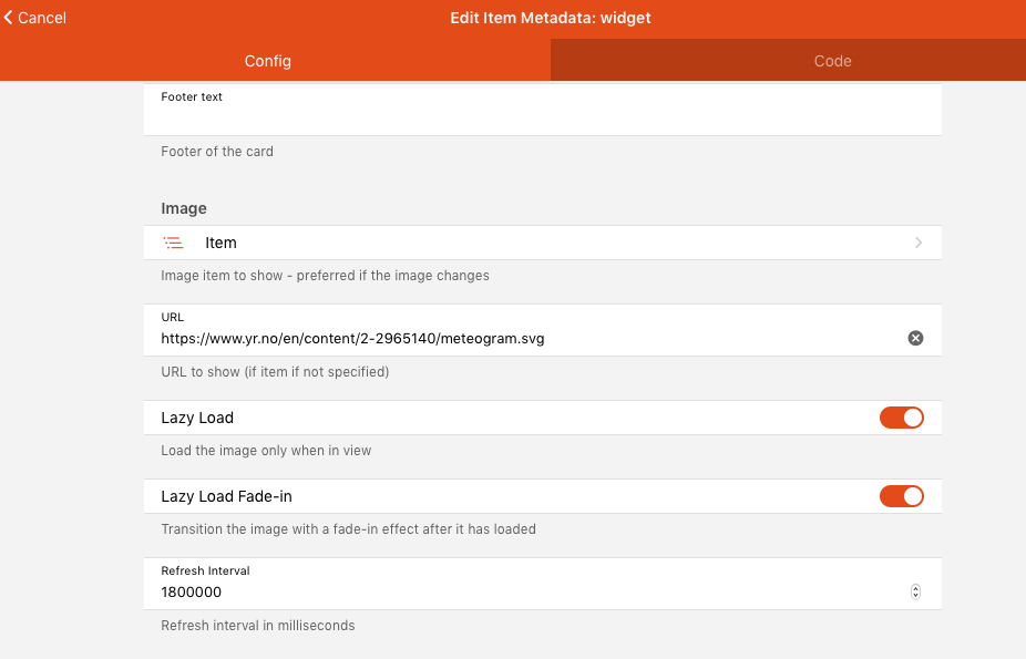

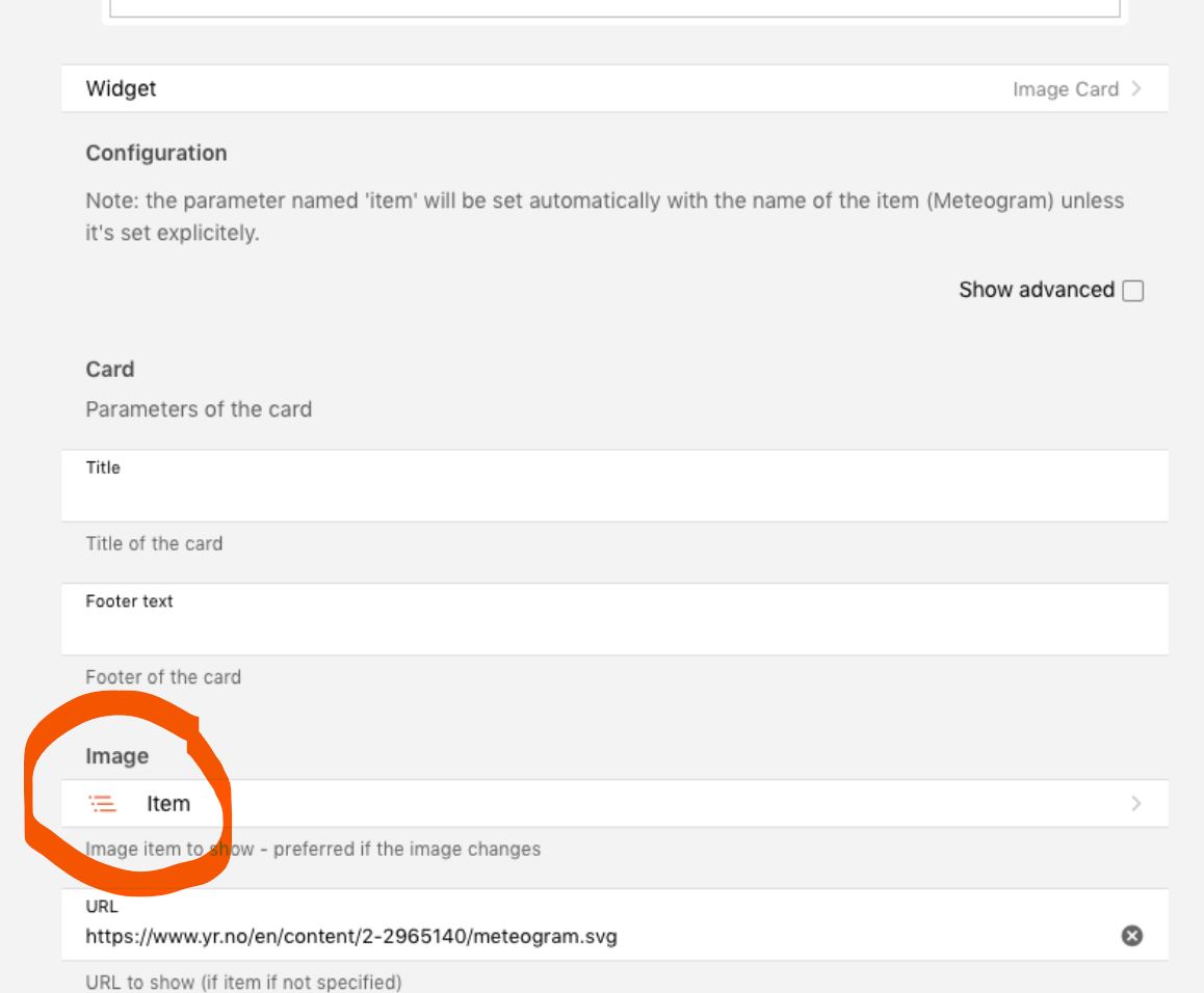

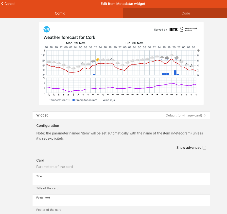

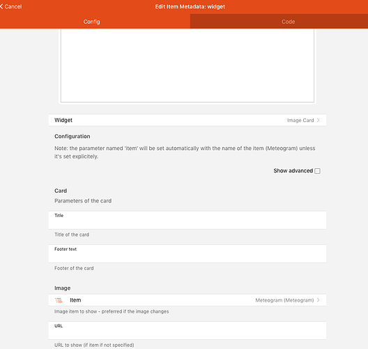

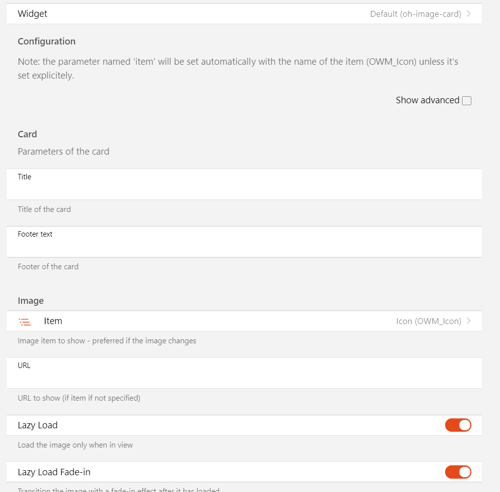

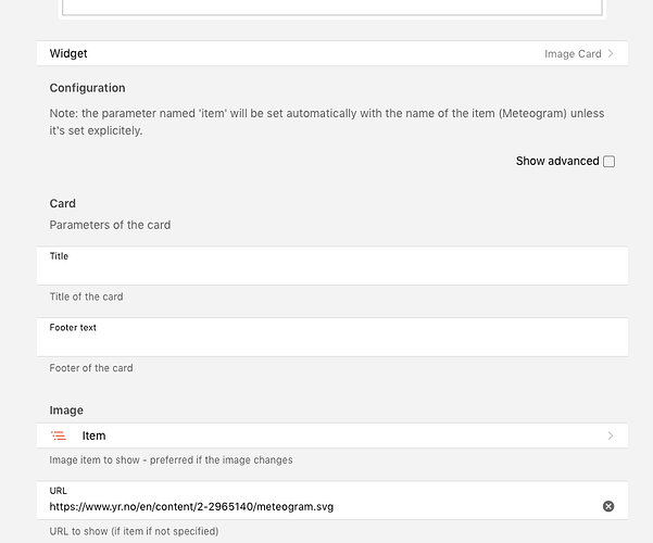

I have tried what you suggested, using an oh-image-card and inserted the url rather than specifying an item, as in the screen shot below. It still doesn’t work. I still get exactly the same weird url appendage about photos and a blank screen when I click the entry inside the card on the main UI. I notice the Image card also has an option for specifying an item, but what item would I be specifying?? All I want is to point the card towards the url and grab the image. How can a simple operation from Sitemaps/OH2 become so obtuse in OH3.. :roll_eyes:

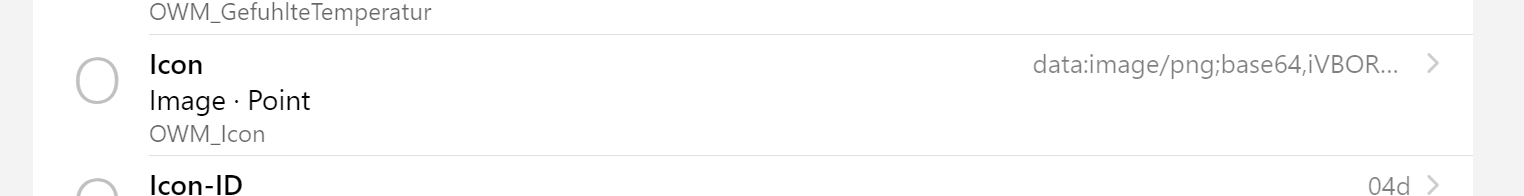

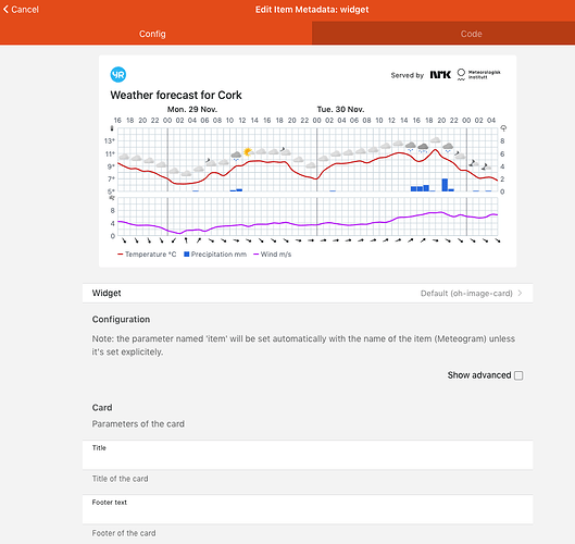

this is an image item:

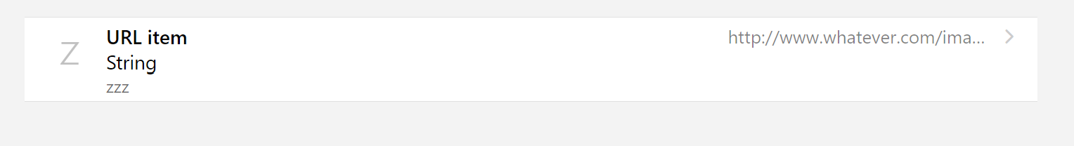

this is a string item which holds a URL:

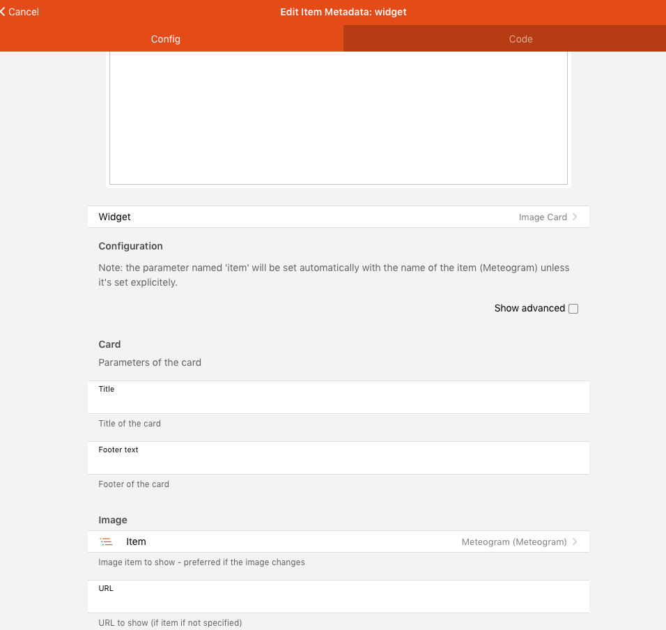

In your settings
delete the URL and pick the item Meteogram.

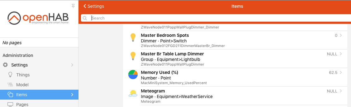

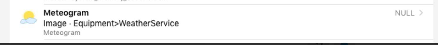

Please also post the config of item Meteogram. I wonder why it is NULL

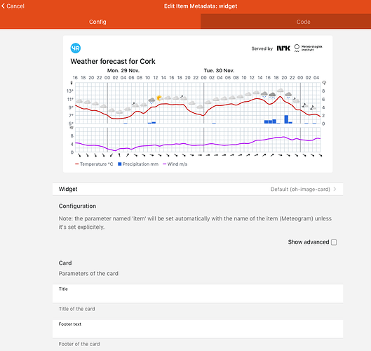

EDIT: and change the default widget to an image-card
tested it on my side. Works without any problems.
You better delete the Default widget metadata from the item and recreate it.
There is nothing you have to do. It works with default settings.

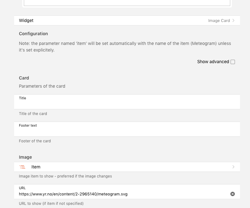

Hi, I have done what you suggested, deleted the url and referenced the item itself in the item field. Still doesn’t work.
Silly question probably: How did you create that url string with the url inside it? I can’t get my head around this in OH3. If I could do that, we could try the string-url approach?

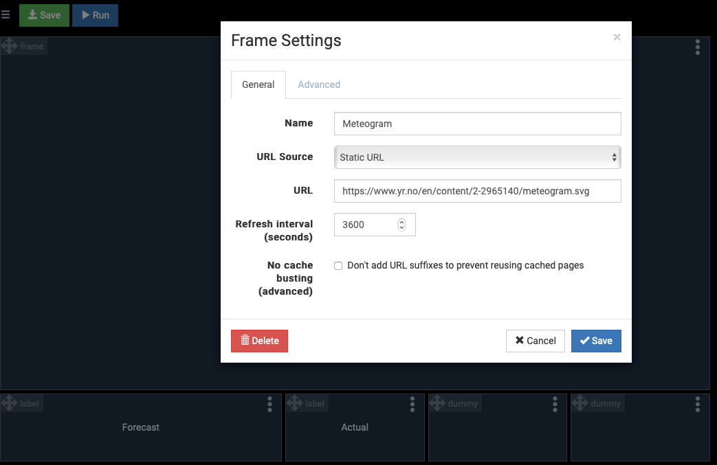

BTW, it works ok in regular old sitemaps AND it also works perfectly in my HabPanel interface that I designed for my iPad. Notice the elegance and simple logic of doing it there.
That is because the item Meteogram is empty.

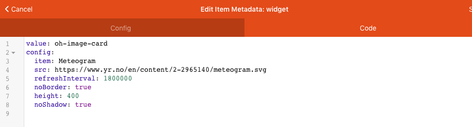

Go to API Explorer and perform a post request to that item
set the refreshIntervall to 10 (I assume that unit here is seconds - but not sure)

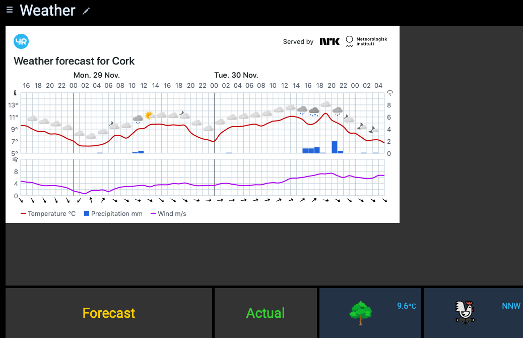

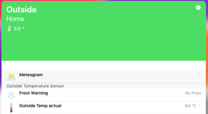

Oliver2, follows your advice. The Card Widgets DO display and update things fine (see screenshots called card widget 1&2) BUT when you want to see the Meteogram by going the normal route of clicking within the UI Card (screenshots UI Cards 1&2) I still get the blank screen because somehow the address is bringing me to a non existing place (photos). This is the crux we can’t seem to solve. Have you tried it with my actual meteogram url and see if you can get the meteogram to display when you click from inside the user interface card rather than just looking at the item itself?
ok. Let’s start from scratch. Your item seems to be empty:

and yes, sure it works partially. that is because your metadata of your item (which is empty) is instructed not to get the image from the item but from a seperate link.
The item isn’t linked to any channel. I just created it on the fly as an attempt to get and display the weather meteogram.
When I launch http://localhost:8080/rest/items/Meteogram/state it returns a value NULL. So it is empty as you say.

ok. I did a complete test. When using a URL string within item’s metadata “Default Standalone Widget” it works within the item but it does not get correctly shown in the GUI (e.g. location tab). Reason for this is that UI tries to access a file in a photo directory but there isn’t one (because the item is NULL).
It does work if you have an image item which contains an IMAGE, not a link to an image. This means that you have to take care about getting the data.

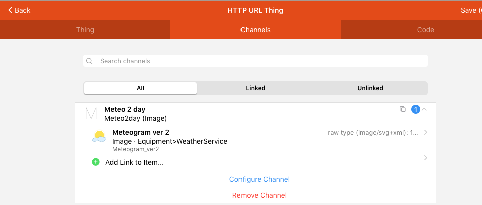

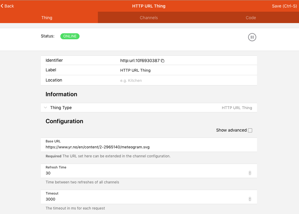

Either you create a rule, or better, install http binding and try to get image through its channel
Oliver2, you’re a GENIUS!!! :grin: :clap: :+1: you could see exactly what was happening on me and you understood the reason for it. thanks so much for your patience and generosity today..good karma for you in the future..
Your suggestion to install and use the http binding worked.

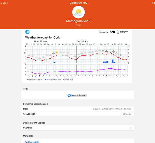

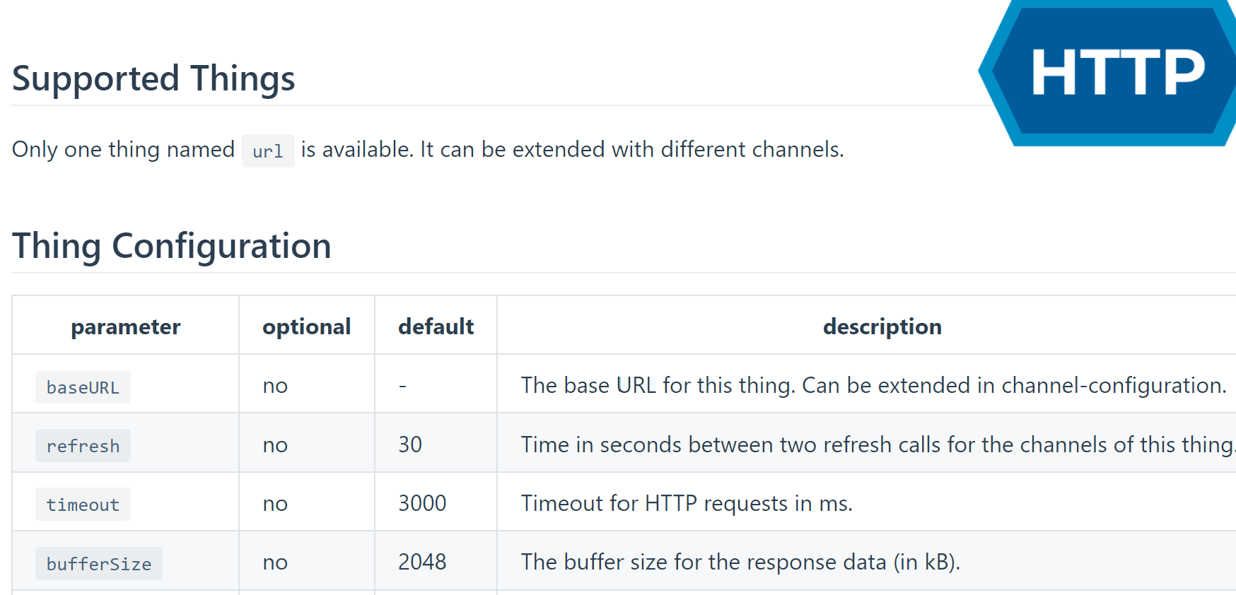

I created a http url ‘thing’ then added a channel (because it didn’t have any), made up a channel ID called ‘Meteo2day’ (because it didn’t have any), then created an image item which DIDN’T seem to need any Metadata or Widgets this time, and linked the channel to this item and hey presto!
I’m unsure about refresh intervals. What’s the refresh time in the thing and what units are they? The Norway meteogram site updates itself every hour apparently. I’d like the http call to only happen every 30 mins. What number should go into that refresh box (if that’s the correct place)?

I attach screenshots to be sure it looks sensible to you.

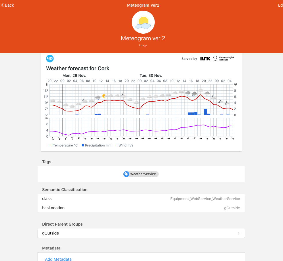

Meteogramver2 not empty

You have to set “refresh” to 1800

enter item name and string
execute
