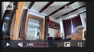

I editet this in a custom widget, anywas, my recordings will not play.
after klicking on the folder icon :
Thank you for posting, it seems a newer version of openHAB now adds underscores into the items when it did not previously. Widget has been edited to fix this.
