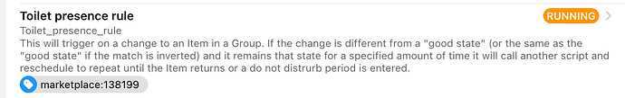

I am curious to look at the Open Reminer Rule Template to understand what it does and how that is useful for the Motion Sensor Timer. But I am even more curious about reading up on how to do state machines, in particular two interrelated state machines (light status and occupancy). Not sure when I’ll find the time…

I have one more question: I noticed that the rule with the template is marked as “Running …” while the timer is counting down:
I appreciate that but it surprised me, because I thought that rules are only “running” as long as they are consuming processor time. So is this not the case?
