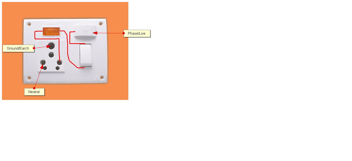

Which comes to another issue–the electrical wiring in your home. Every z-wave switch that I know of requires a real neutral wire – i.e., there are 3 wires involved. Many Indian homes do not have this type of wiring - they have only two-wire with NO neutral.
To be clear the switches are two wires, but usually the switches are clubbed together with a plug in socket which is 3 wire ie earth, neutral and live.

On the subject of 2-wire vs 3-wire, the light switches are 2-wire ones. But take a look at this sample image from the internet
Cant the neutral from the socket be used with the switch?

You should speak to an electrician. Certainly in the UK and Europe, the answer would generally be NO - you can not mix lighting and socket circuits. India might be different of course…
