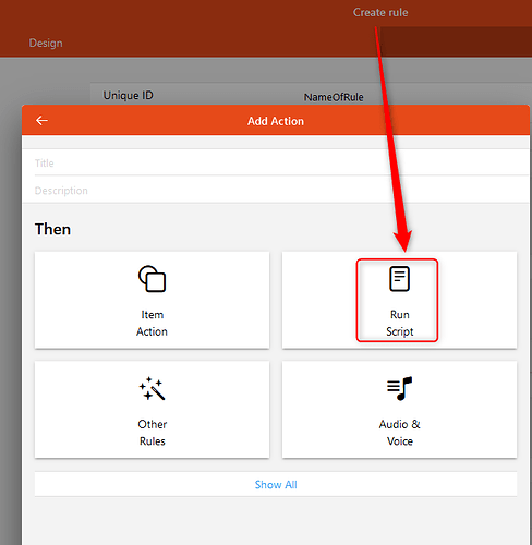

If I understand correctly, you would like to add a rule using DSL (aka “the old openHAB2 way”?) instead of ECMAScript (aka “one of the rules-integrated scripting languages”)?
Do not copy-paste the whole of a “file” type DSL rule into a GUI entered rule’s script action.
The GUI takes care of all the when-then-end stuff and you only need the rule body.
That’s correct - but one step at a time I guess! if you copied all the “old” rule as a whole, you get the corresponding error-entries in the logs and can work from there!
I managed to it thanks to all!
The only thing that did initially was not clear to me is that
“The Rule can embed a script”.
I thought I have to create a script and link it.
