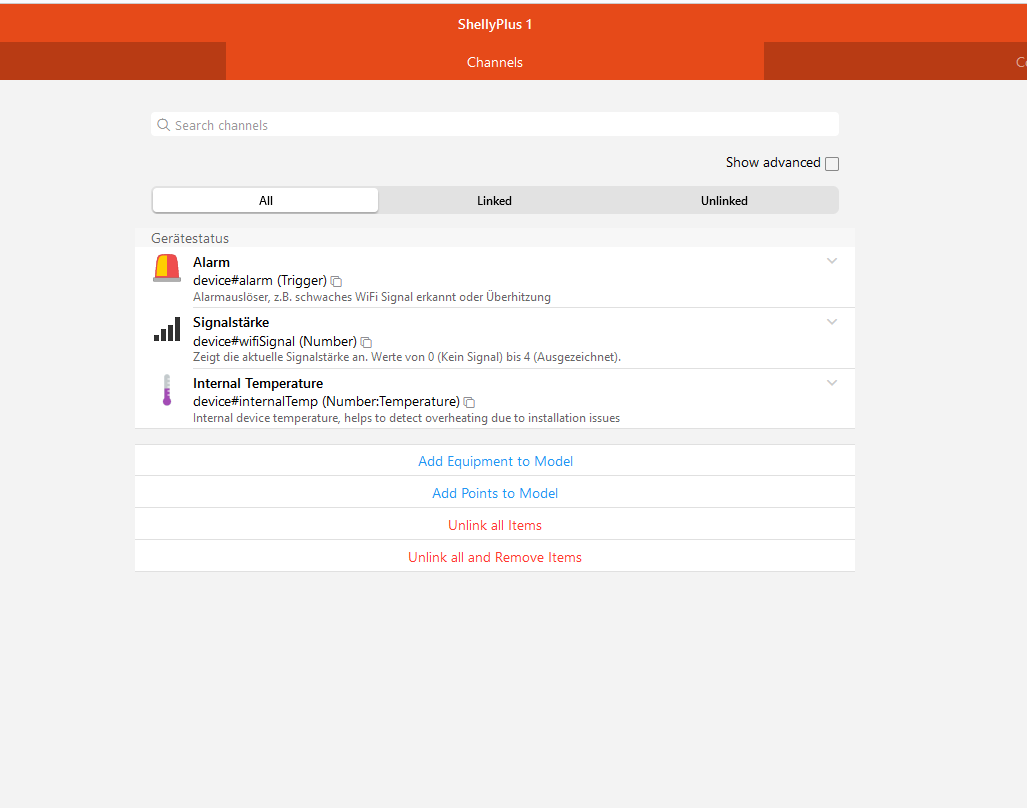

I’have cleared my test system so it is plain empty.
I have instaled the Shelly Beta binding and it seams to be correct.
281 │ Active │ 80 │ 0.3.0.v20220506-1020 │ EdDSA-Java
282 │ Active │ 80 │ 2.7.4 │ Californium (Cf) Core
283 │ Active │ 80 │ 2.7.4 │ Californium (Cf) Element Connector
284 │ Active │ 80 │ 2.7.4 │ Californium (Cf) OSGi
285 │ Active │ 80 │ 2.7.4 │ Scandium (Sc) Core
288 │ Active │ 80 │ 4.1.0.202308122207 │ openHAB Add-ons :: Bundles :: Shelly Binding Gen1+2

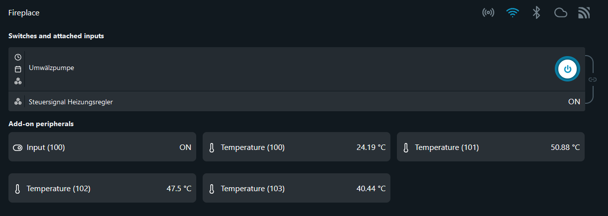

Then I’ try to add a Shelly Plus 1 as a thing. It seams to work, as it adds a thing that seams to be correct but no matter what I’ try the Thing has some intenal channels but all the functional chanels (relay switch, addons) are missing.
