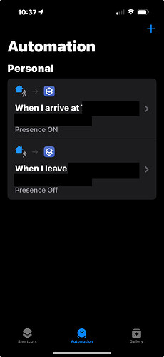

Geofencing is just a feature of (primarily) mobile apps, your phone triggers a command to the device (usually through the manufacturer’s cloud) based on a rule in the app. There is likely no “geofencing” support built into the actual thermostat itself, or most hardware like it. You could do the exact same thing with the openHAB iOS app, setup a shortcut in the “shortcuts” app to send a command to an item (ON) and the setup an automation when you enter or leave an area that runs it.
Here’s a screenshot from the iOS shortcut app, i have two shortcuts, one to turn ON and one to turn OFF an item in openHAB
Then i have an automation to run those when i enter or leave a geofence around my home.
