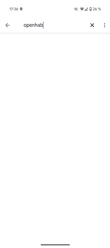

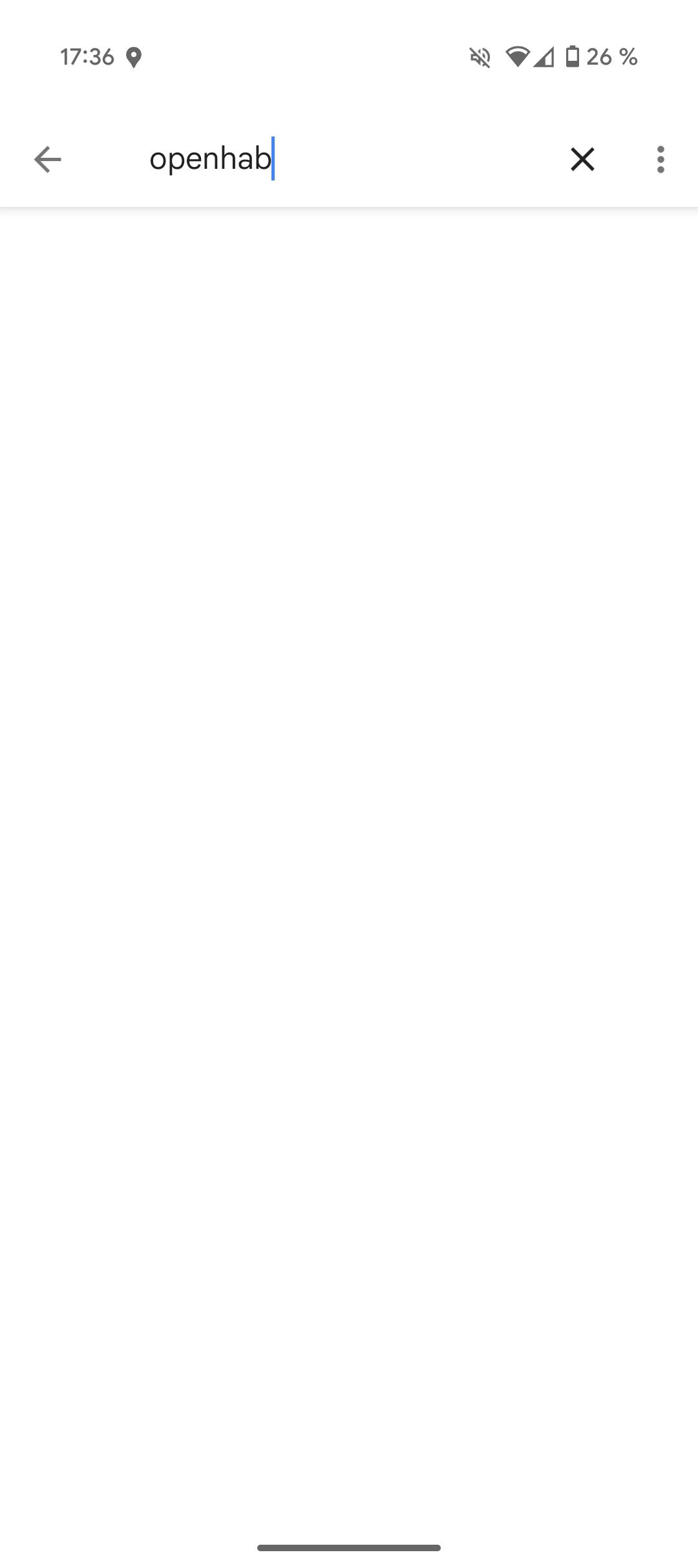

I cant remove and reconnect openHab to Google home.

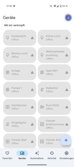

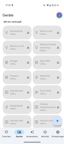

There are still devices from my old configuraton
But I don´t see openhab:
I hope the screenshots will help.

I tried that.
Then I am redirected to the window where I can see the services linked to Google, but openHAB is not there. So I can neither delete the device nor relink the service.
It wouldn’t be any more. You’ve unlined it. You’d have to hit “+ Add” → Works with Google Home and you should find openHAB in that big list again.
If you’ve failed to unlink it, you’ll still see openHAB at the top. But it seems you can unlink and reconnect to openHAB from there without removing the devices first.
I use Matter to integrate OH with Google Home now so what I see is different from what you’ll see.
This is not possible for me, because I ca´t see openHAB in the big list.
