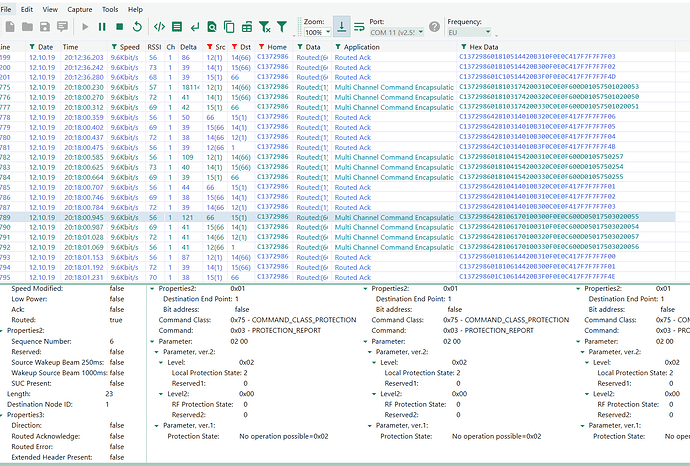

I have seen it for just from one zniffer on one device but certainly for this one device it has requested a report immediately after the command every time. I need to get a few more devices tested and of course it could be a UI issue.
One thing to be careful of, and that is when timing starts. The poll is timed from the time the command is queued, and not from the time it is sent. So, if there are delays in that transaction, then the poll will also be queued, and it could therefore be sent immediately after the response from the command.
I tried setting the poll after to disabled and still got a report request and set to a large value and it still was almost immediate. As I said I have not dug deeper yet so could be an issue with UI not setting the value.

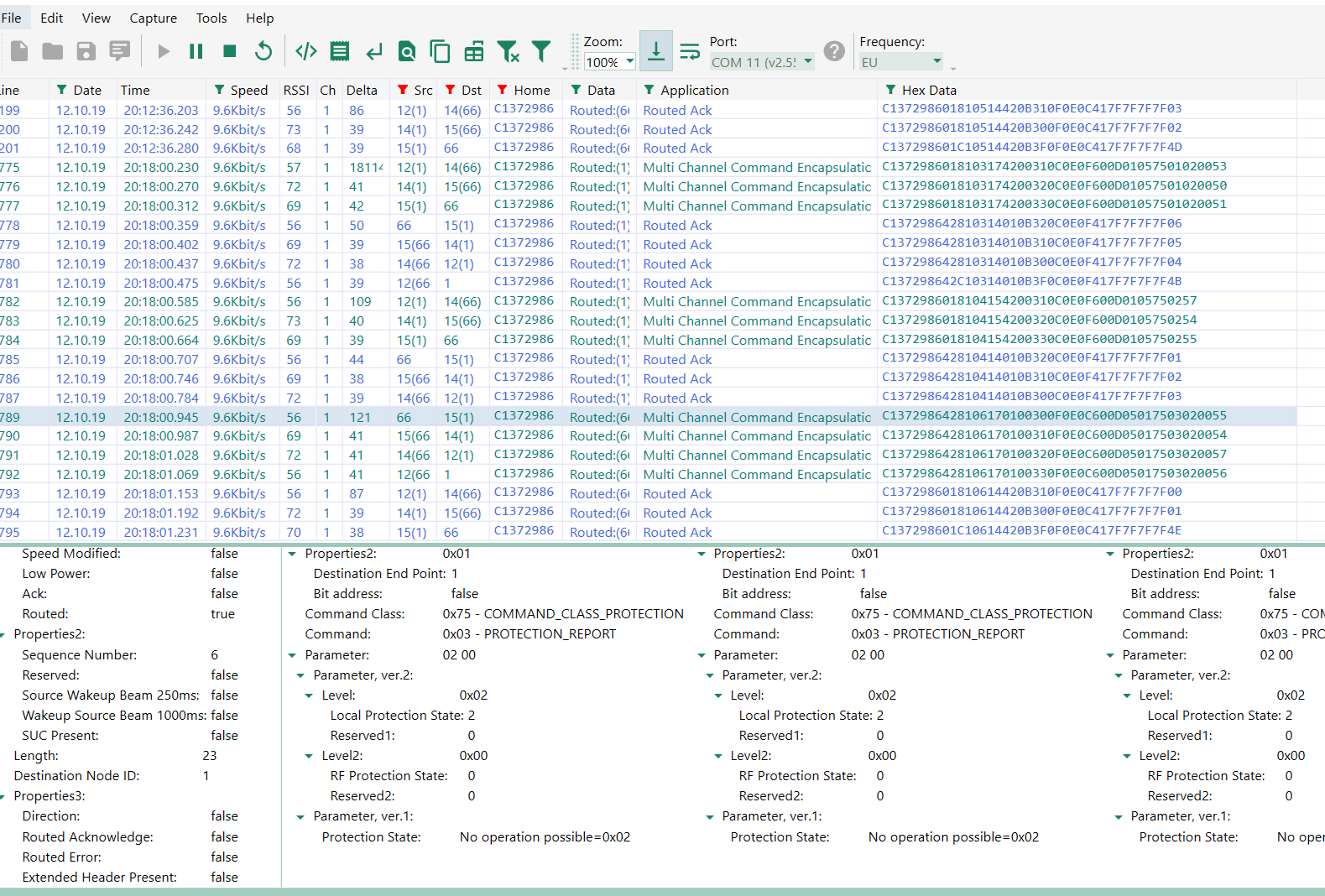

You can see the issue here.
The first command is the set from 1 to 66. you can not see first hop as zniffer is out of range of controller
The second is a request for a report from 1 to 66.
The last is the report returned by the node 66 to 1.
What I can see in the log s similar stuff to that posted above. I am sure it was not like that until I took the snapshot.
It’s not super easy to work this out - I agree there are multiple commands being sent in reasonably quick succession, but I can’t decode the data in my head.
Can you provide the debug log for this sequence so I can see what the binding thinks it’s doing?
I will search it out.
There is another picture with the original request highlighted but i did not take a snip of the middle request for a report.
Not sure it is exact instance. You can see it sent a set quickly followed by a get. This was on an earlier snapshot. All that was done was change the setting.

So that was on a snapshot earlier this week. Then I took the snapshot from 17th and while it is working I am also getting odd todo that I can not see prior to this.
Not surprised by the timeout as it is a stretched route with a few nodes at the end but not sure about this.

Also when it says canceled this is not a CAN from the serial interface when there is a buffer clash between putting a serial message into the controller when the buffer is in use by an inbound message but just a timeout. Is that correct?
I can’t really compare these two logs as they appear to be of different things. The first one is sending a command, and the second one doesn’t have this. It shows what is probably a timeout, but I’ve no idea what has timed out so it’s hard to really say what is happening.
Also, please can you format commands with code fences, or using the </> button rather than as a quote, or whatever, as that has added characters and it’s not super easy to read.
First one shows one issue and the other another. Not asking to compare.
The first log shows sending one command that i initiated
Creating new message for command PROTECTION_SET
and another that I did not.
Creating new message for command PROTECTION_GET
Is that not a bit odd?
The second only after I put on the later snapshot
what is that about?
This converter always seems to do this, so no, it’s not odd.
I don’t know. As I said above, it would be useful to see the command that was sent.
Apologies but that log is 16K so I snipped a bit. I think it is a polling request during initialisation. Do you want the complete log?
