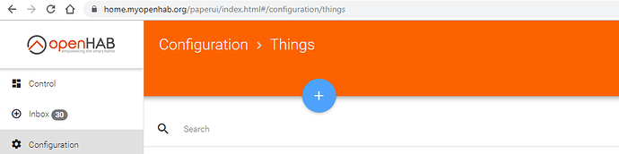

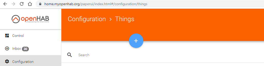

I can access the paperui by myopenhab.org

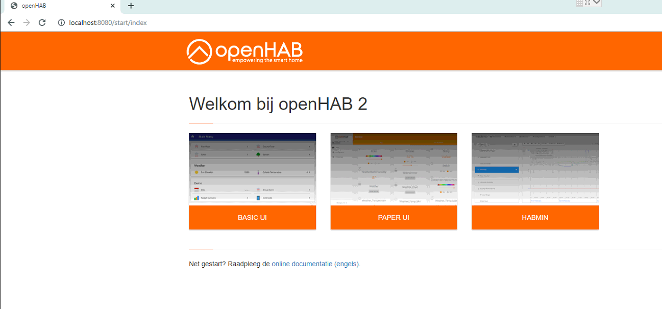

I can open the paperui by localhost:8080

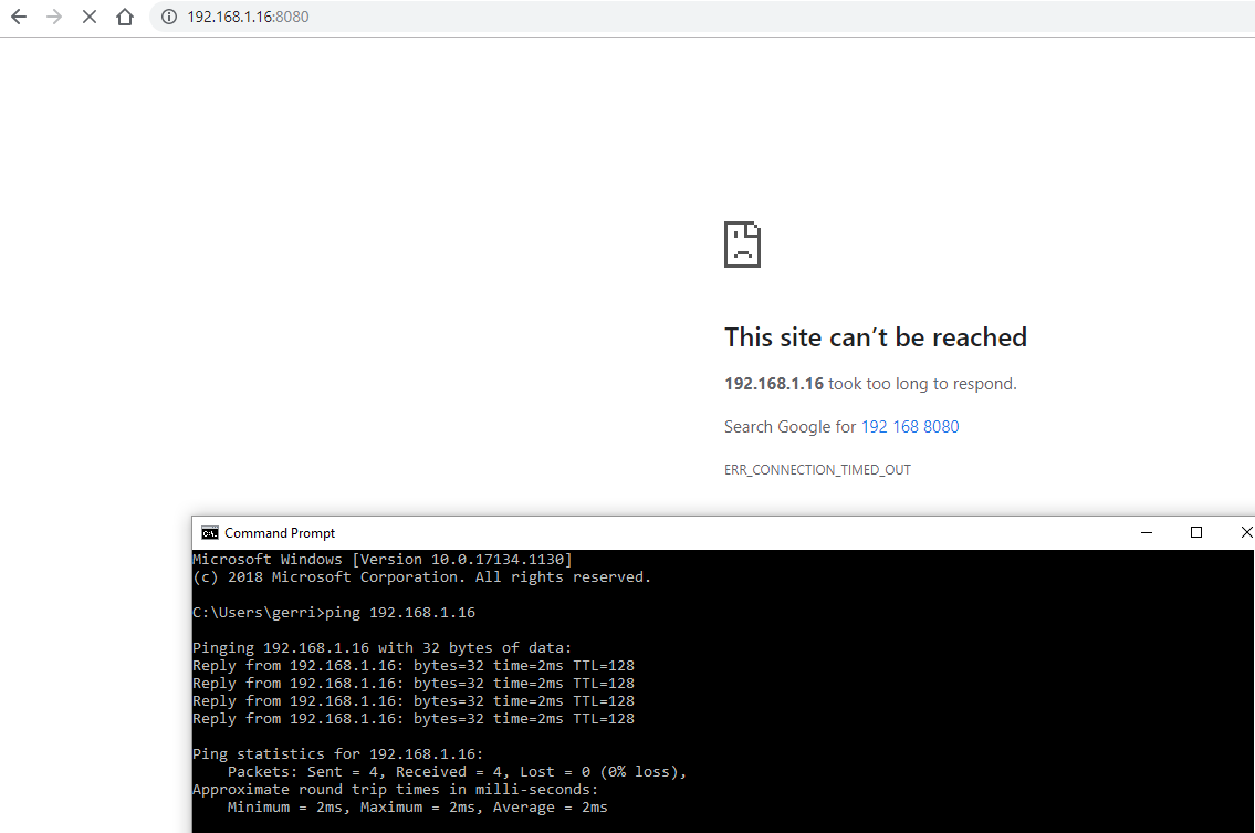

But i cannot access it by its ip adress 192.168.1.16:8080
I can ping the openhab pc

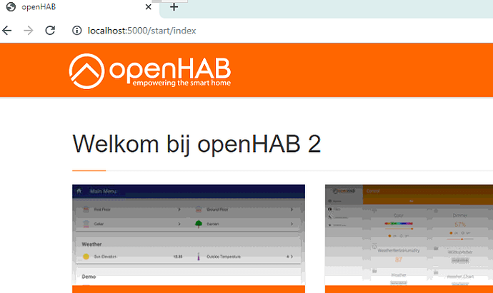

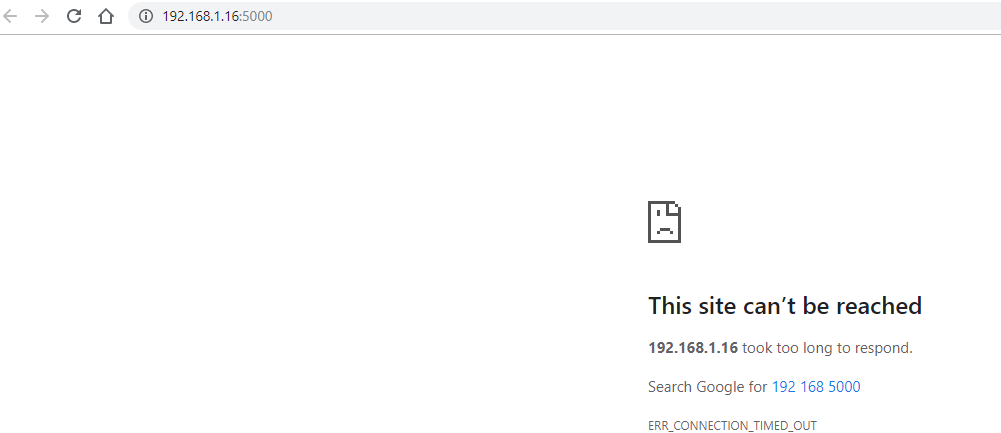

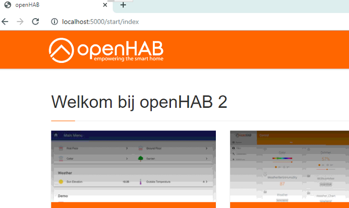

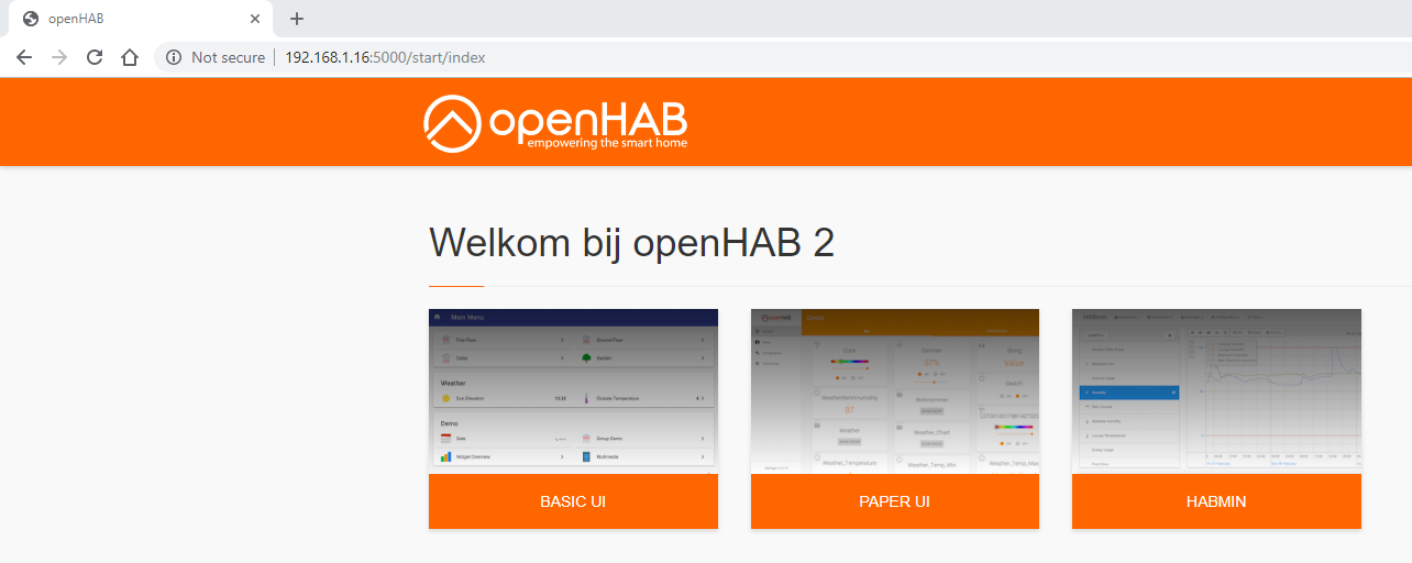

i have changed the port to 5000
it works local, but not with the ip adress
Try using sudo openhabian-config tool and use fix permissions, add needed packages, svr mounts, etc… then clean the cache and reboot.
i was at a client location, but the clients network is the same as mine at home.

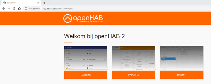

So i had the openhab windows pc started at my place and i then opened 192.168.1.16:5000 and bammmm that worked.
So there has to be a difference, but i have no clue…

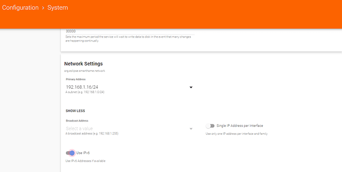

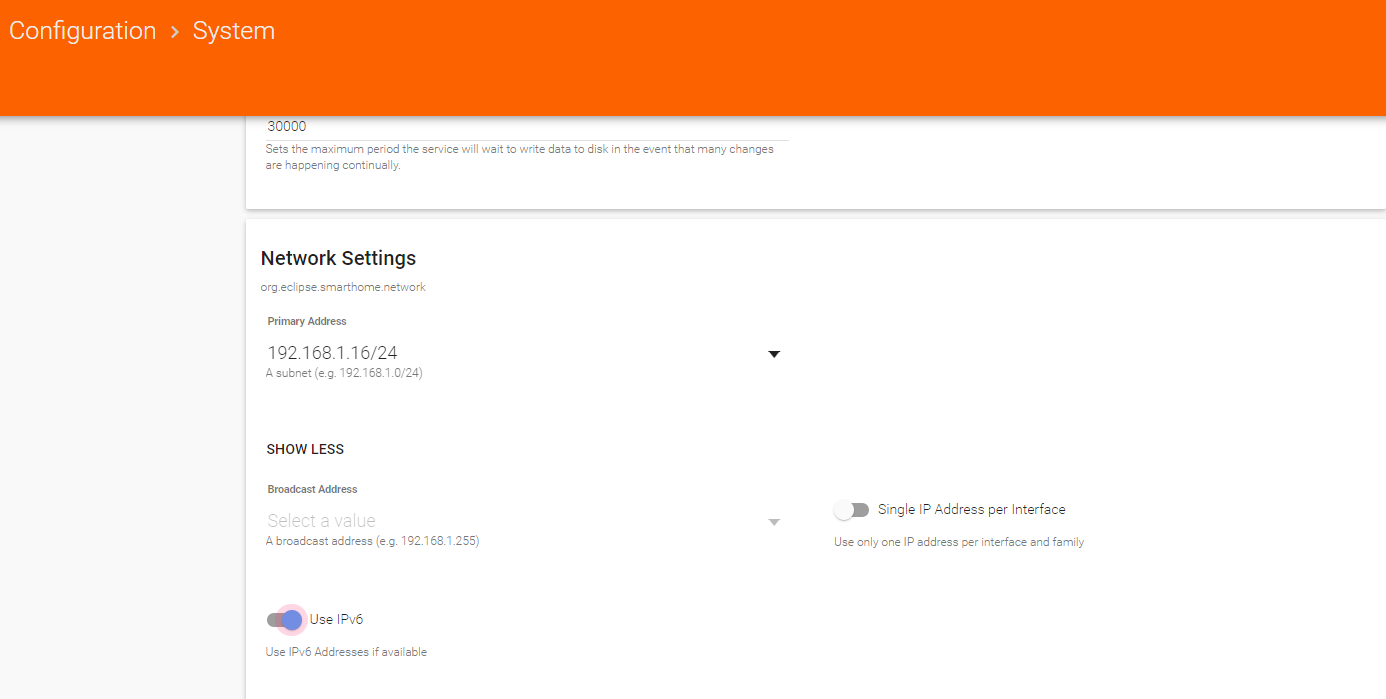

I checked the ip adress and i see it is 192.168.1.16/24
So that is OK.

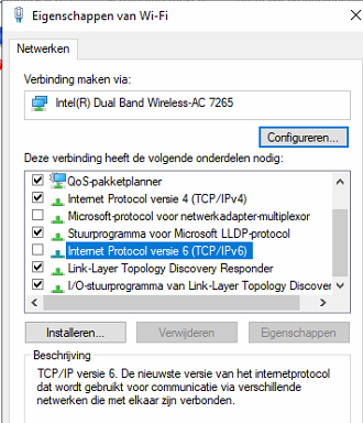

I am guessing it could be the ipv6 adress
I have unchecked it for now. I hope it will work.
I have also unchecked the ipv6 adress on the windows device.
problem is solved. It was the ipv6 settings
