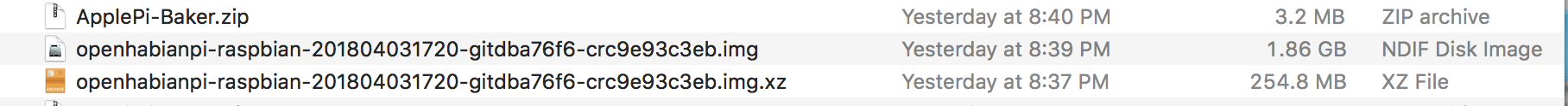

How did you install it?
Github!
used Matt Kaczynski’s instructions to flash the SD card but followed the official openhab instructions
