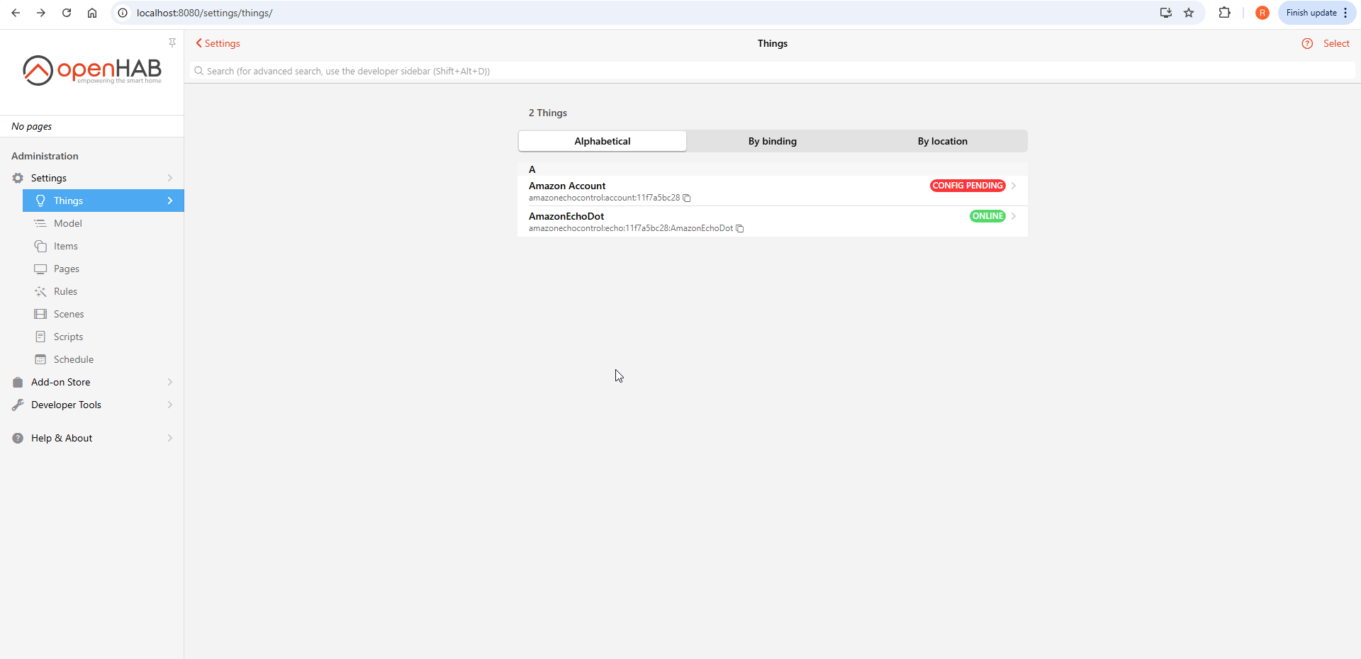

I’ve tried adding my Amazon account multiple times, but it always ends up in the OFFLINE state with CONFIGURATION_PENDING. Because of this, I can’t add any of my Alexa-connected devices (such as switches and lights) as Things in openHAB.
After entering my Amazon account credentials and passing the two-step verification, I always get stuck at this point.
