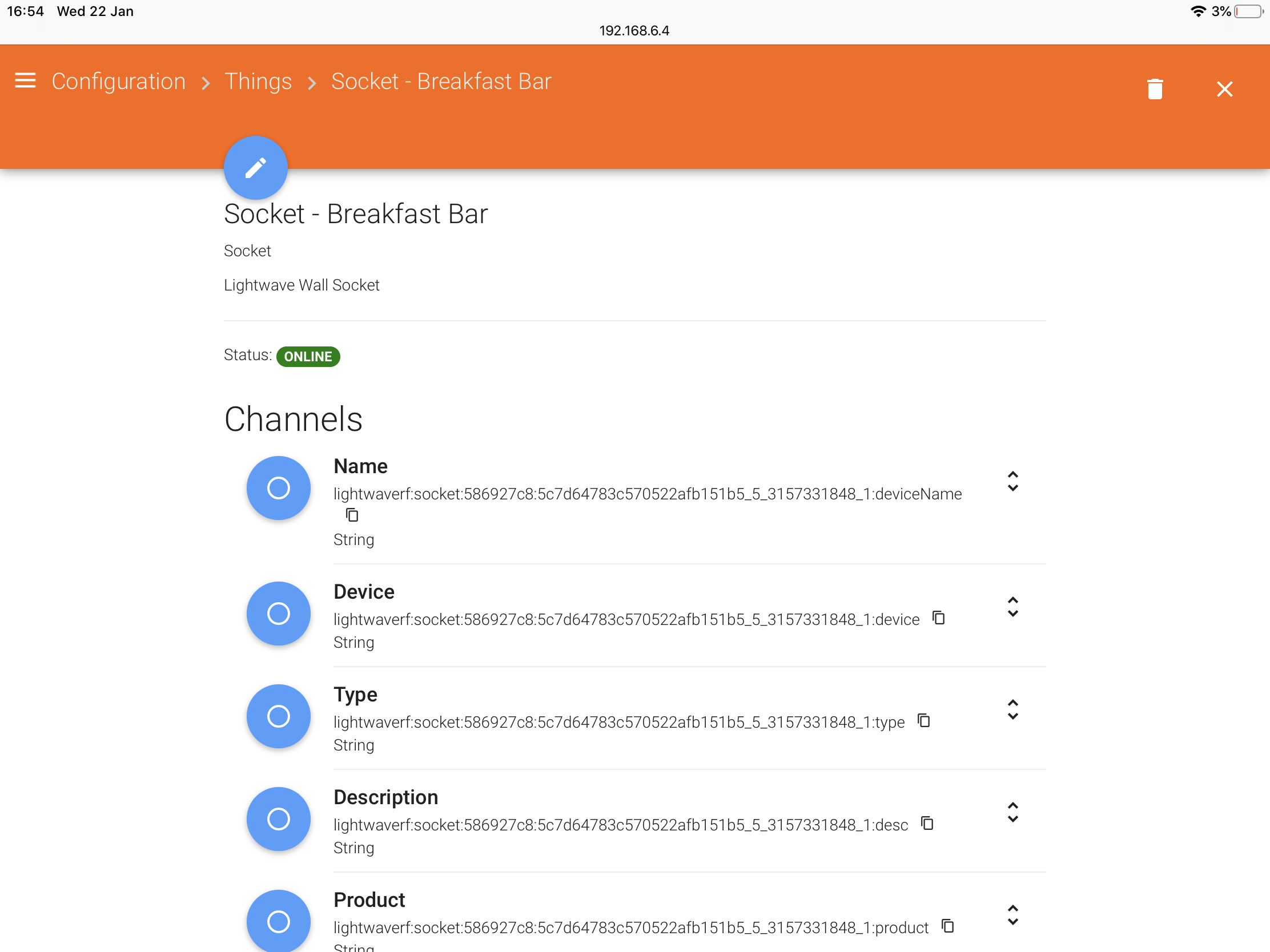

@Mathew_Cook have put up a test version of v2 LightwaveRF binding here:
