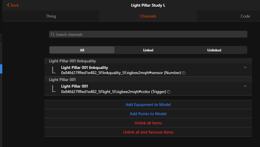

Due to some recent problems mit deCONZ binding, I wanted to give zigbee2mqtt a try. Zigbee devices (2 Lidl Livarno Home LED floor lamp and 1 TRADFRI remote control) appear in my INBOX in OH.
But I cannot control the lamps.

UID: mqtt:homeassistant_zigbee2mqtt_5F0x84fd27fffed1e482:7f39f227e2:zigbee2mqtt_5F0x84fd27fffed1e482
label: Light Pillar Study L
thingTypeUID: mqtt:homeassistant_zigbee2mqtt_5F0x84fd27fffed1e482
configuration:
  topics:
    - sensor/0x84fd27fffed1e482/linkquality
    - light/0x84fd27fffed1e482/light
    - select/0x84fd27fffed1e482/effect
  basetopic: homeassistant
bridgeUID: mqtt:broker:7f39f227e2
Is it bc of the limitations?
The HomeAssistant Light Component only supports RGB color changes.
If not, what do I need to change? :thinking:

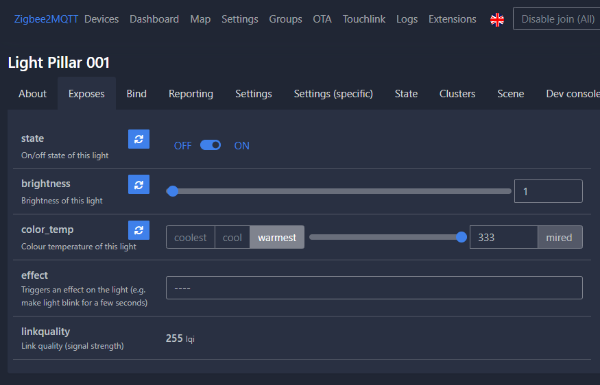

zigbee2mqtt is running fine, I can control the lamps there:

I tried that, but whenever I edit the code of the thing in the UI, everything below bridgeUID disappears. What am I doing wrong?
Did you create the thing and save it first? After this you should be able to edit it again and do enter your adjustment.
Did you do a copy and paste? Then maybe the structure of the yaml is not proper - spaces e.g. matter.
yes, thing is created in first place.
I created a recording for better explanation (sorry for the wrong aspect ratio)
Ok, got it. You need to create the thing from scratch as a generic mqtt thing. From what I saw you are editing the thing created by the HA discovery. This will not work.
