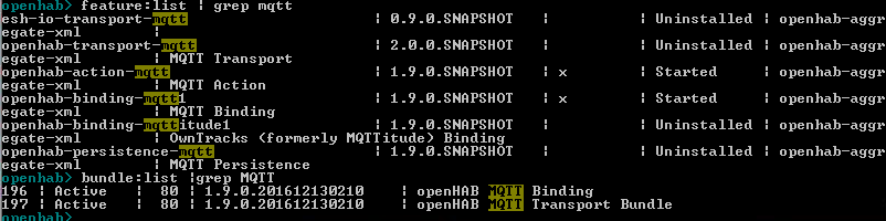

I keep getting information in the log about broker connection started with previous used brokers (i renamed it a few times in MQTT.CFG):
[INFO ] [t.mqtt.internal.MqttBrokerConnection] - Starting MQTT broker connection ‘mqtt’
[INFO ] [t.mqtt.internal.MqttBrokerConnection] - Starting MQTT broker connection ‘oh2’
[INFO ] [t.mqtt.internal.MqttBrokerConnection] - Starting MQTT broker connection 'mqtt1
and so on..
I see alot of:
[ERROR] [t.mqtt.internal.MqttBrokerConnection] - MQTT connection to broker was lost

I guess you are affected by a little bug which can be resolved:
I was shooting everywhere this morning, and it finally worked!
What i did to resolved it was:
  • Changing the MQTT server to another port (and offcourse the clients)
  • Deleting the file: \userdata\config\org\openhab\mqtt.config
Hope it can help other people in the same situation.
