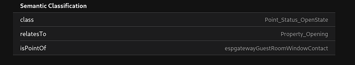

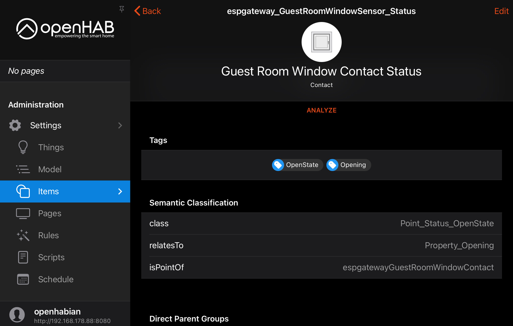

Thanks for your swift replay! Actually I was thinking the same, but when I looked to the Item page
The semantic is there, so I would expect the function
get_metadata()
to return all the values, as in the attached example. Apologize to have missed the attachment before.

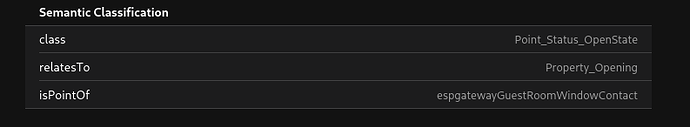

correct me if I am wrong, but I think that
are metadata of the
 espgateway_GuestRoomWindowSensor_Status
I then expect the function
equipmentName = get_key_value(itName, "semantics", "isPointOf")
to return (as in the working example)
[key=semantics:espgateway_GuestRoomWindowSensor_Status, value=Point_Status_OpenState, configuration=[relatesTo=Property_Opening, isPointOf=espgatewayGuestRoomWindowContact]]

That does appear to be added to the Item metadata on the fly. If you search org.openhab.core.items.Metadata.json though you will not find a semantics metadata anywhere. But the REST API does appear to return that metadata.
But, are you aware of the semantic actions? Actions | openHAB. You don’t need to mess with Item metadata to see what equipment and location an Item belongs to in the model. Just use the actions.
I don’t know the nature of this metadata that is created on the fly. I suspect it may not exist until the Item is loaded in MainUI or something like that. It’s not permanent or else it would be in the Metadata.json file. But the Actions will always work.
