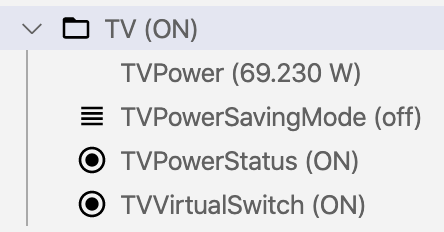

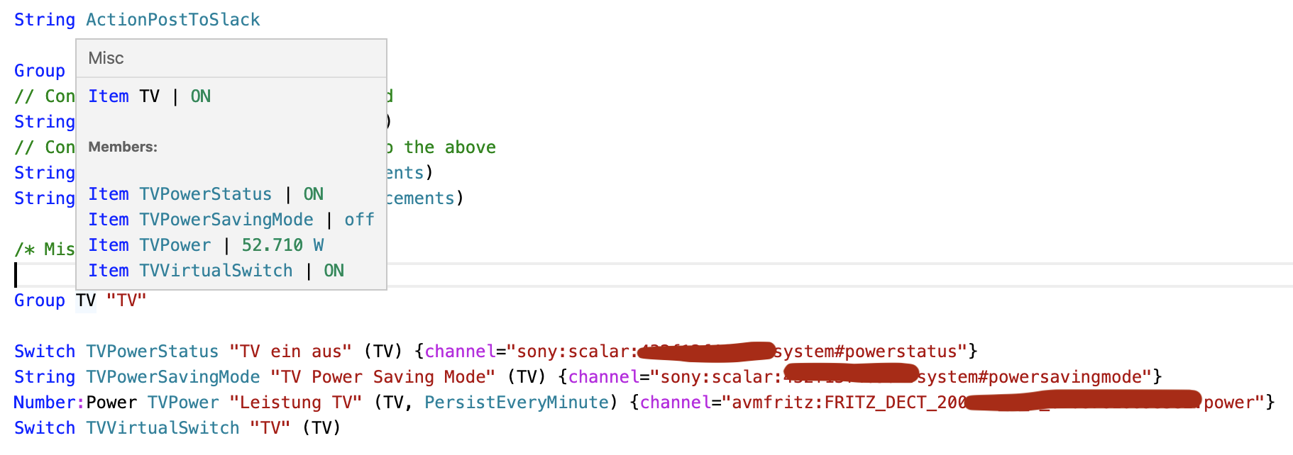

there is a group in my setup called “TV” that appears to have an ON/OFF value. In other words it acts as if an aggregation function were defined, but there isn’t. Screenshots from Visual Studio Code. Mouse hovering over group item to show current state:

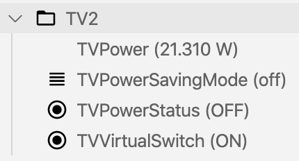

If I rename the group to “TV2”, the phantom ON/OFF value is gone. If I rename it back to “TV”, it’s back to its broken state.
