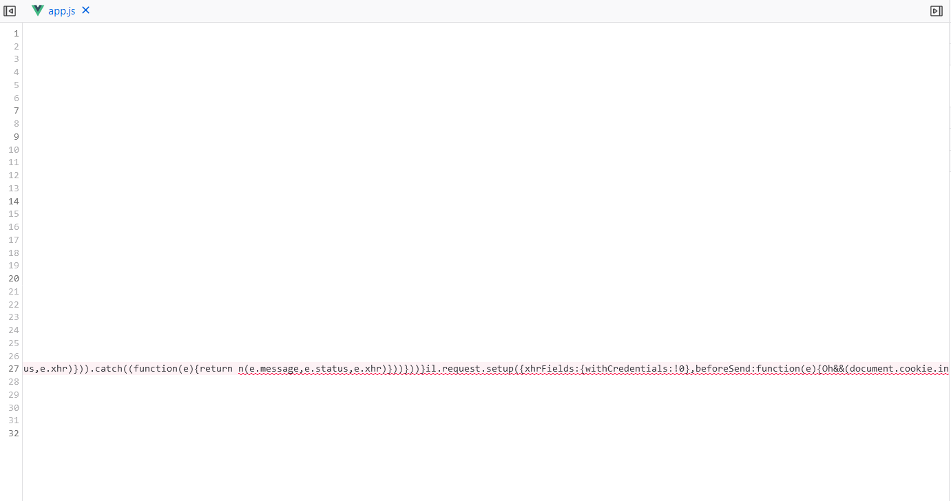

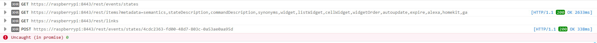

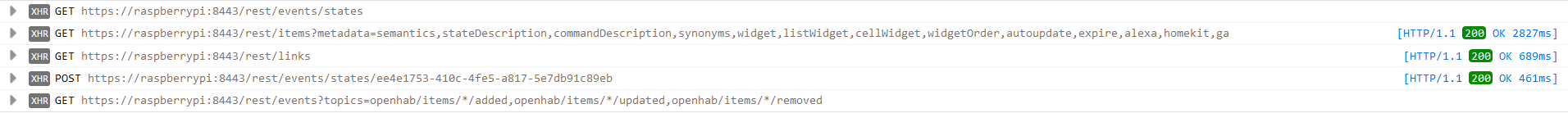

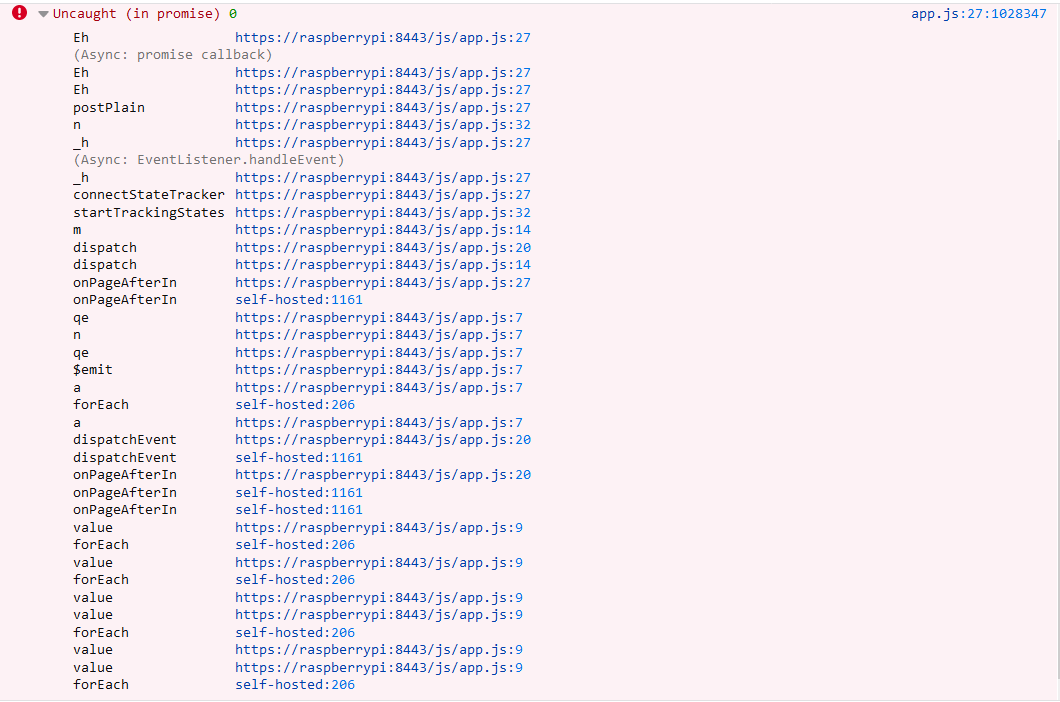

I am not experienced in debbuging client side JavaScript code. Anyway I toggled the switch in the debugger of Firefox to stop the application in case of an exception. This is the information, that I could gather then:
