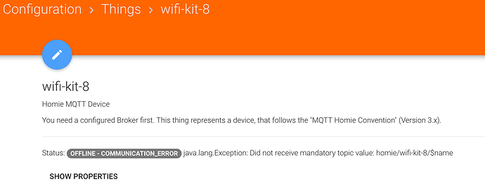

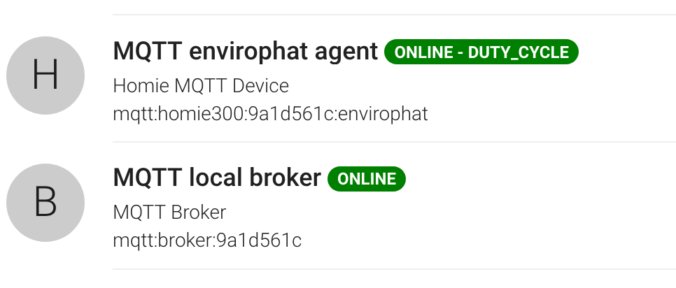

I have successfully added one device from MQTT to OpenHAB using the Homie convention:
Now I’m trying to add another device the exact same way, and it doesn’t work. I tried rebooting many times the devices and openhab, but I always get two types of errors back:
  • either Did not receive mandatory topic value: homie/wifi-kit-8/$name
  • or Did not receive mandatory topic value: homie/wifi-kit-8/$state
I’m using mosquitto as a MQTT broker which is installed on the same Raspberry Pi as OpenHAB

2020-08-25 21:47:31.617 [WARN ] [.incoming.MqttIncomingPublishService] - No publish flow registered for MqttStatefulPublish{stateless=MqttPublish{topic=homie/wifi-kit-8/$name, payload=18byte, qos=AT_MOST_ONCE, retain=false}, packetIdentifier=-1, dup=false, topicAlias=0, subscriptionIdentifiers=[]}.
2020-08-25 21:47:32.364 [home.event.InboxAddedEvent] - Discovery Result with UID 'mqtt:homie300:9a1d561c:wifi-kit-8' has been added.
2020-08-25 21:47:32.363 [INFO ] [g.discovery.internal.PersistentInbox] - Added new thing 'mqtt:homie300:9a1d561c:wifi-kit-8' to inbox.
2020-08-25 21:47:42.986 [me.event.InboxRemovedEvent] - Discovery Result with UID 'mqtt:homie300:9a1d561c:wifi-kit-8' has been removed.
2020-08-25 21:47:43.000 [hingStatusInfoChangedEvent] - 'mqtt:homie300:9a1d561c:wifi-kit-8' changed from UNINITIALIZED to INITIALIZING

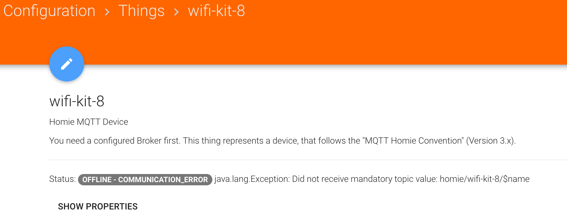

2020-08-25 21:47:43.549 [hingStatusInfoChangedEvent] - 'mqtt:homie300:9a1d561c:wifi-kit-8' changed from INITIALIZING to OFFLINE (COMMUNICATION_ERROR): java.lang.Exception: Did not receive mandatory topic value: homie/wifi-kit-8/$name
Does it have anything to do with the log entry “No publish flow registered for MqttStatefulPublish”?
Am I doing anything stupid?
