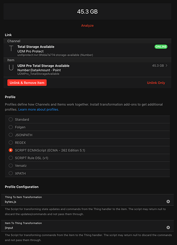

You need to make sure that the rule āknowsā whether to execute the code as Edition 5.1 or Edition 11 (in reference to your screenshot).
For each single rule click in the config settings on the ā>ā symbol of this setting:
execute an inline script >
and select the correct edition. They should work now.
This way you can migrate your rules 1:1 over time.

2024-03-21 07:15:54.500 [ERROR] [.module.script.profile.ScriptProfile] - Failed to process script ābytes.jsā: Script type ājsā is not supported by any available script engine.
This is the script ābytes.jsā:
(function(i) {
return i + "B";
})(input)
I guess, if all add-ons are installed correctly, this should still work.
