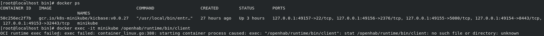

I am using openhab 3 and going from a native install to docker and kubernetes. I am using minikube and when trying to run the console I get the following error:
“”/openhab/runtime/bin/client": stat /openhab/runtime/bin/client: no such file or directory: unknown"

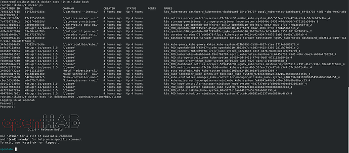

You have pointed me in a good direction. Finally I have managed to access with the following commands:
$ docker exec -it minikube bash
# List all containers
$ docker ps
# Select the container id
$ docker exec -it <container id of entrypoint>  /openhab/runtime/bin/client
# Entry the password: habopen
I hope that between the contribution of @lukics and mine it can be of use to someone.
