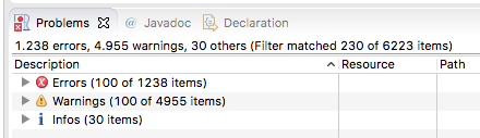

I’m working on a binding for the Rachio sprinkler system and want to verify compatibility with the most recent release. So I removed the openhab-master in the file system, did a fresh install, Eclipse is fully initialized, but now I get tons of errors.
A first thing that I found out is that multiple bindings are using the JSience API, but it seems that the jar was not added to the dependencies.

  • I deleted the openhab2-master directory tree
  • then run the Eclipse Installer
  • Selecting Java->all openHAB projects
  • Eclipse->Workbench, wait until everything is build
The result:
most common issue: several projects using the JScience API - javax.measure.*
15
08
I’m using macOS.

result is even more worth: more than 7000 errors! :frowning: There are many new .test projects, some major activities are going on.
It seems that some global repository / dependency definitions are missing. It doesn’t find a lot of javax.* modules, but also org.jupnp.* etc. are missing.

You have to add another software site to the target platform
  • open project infrastructure->launch
  • double click openhab.target
  • click on Locations->Add
  • click add->software site
  • select Software Site->Next
  • click Add
    Enter any name
    site: http://eclipse.github.io/smarthome/third-party/target/repository
    ok
  • open Maven osgi bundles
  • scroll down the list
  • checkmark all tec.unon.* and Units of Measurement*
    Finish
  • Click Reload Target Platform in the upper right corner
    Save
  • Rebuild starts
  • Open project Runtime->openhab.core.karaf
  • double click on the pom.xml
  • click on the red message “Plugin execution not covered…”
    click “Mark goal highest…”
Maybe some errors are remaining, but those are related to specific bundles and could be ignored / delete the associated projects.
and go :slight_smile:
