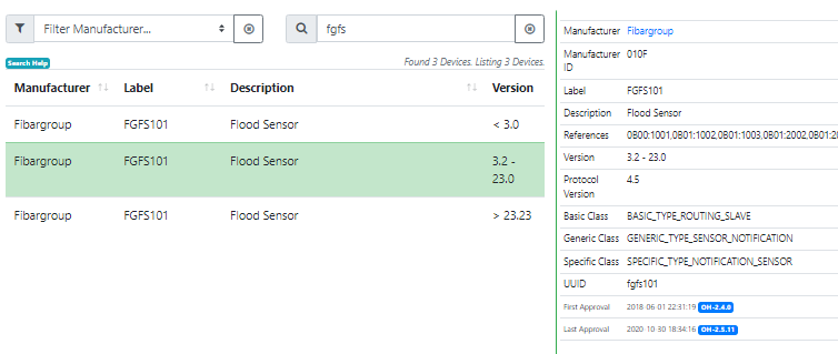

Edit2: looking at the DB there are three FGFS-101. What version do you have? And are the ones that work the same version?
Is that the Z-wave version in properties? Or deviceid in the xml?
The Z-Wave versions are 3.2, 3.2, 3.2, 3.3 and 3.4. In any case I don’t see a pattern because the sensor that I excluded and re-included formerly showed the complete set of command classes in the xml, but now doesn’t. I wonder if there’s some difference between including it from OH and from PC Controller.

You are probably right. All these are the same device in the DB.
