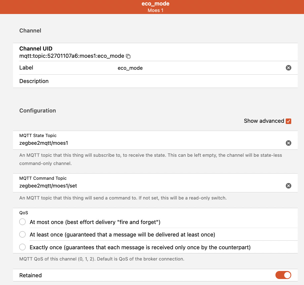

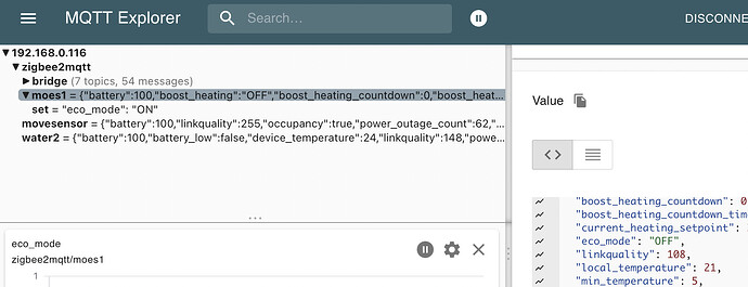

Please help. I connected the device and received its parameters through the broker.
But I can’t configure the channel to change the parameter. The pictures show what the channel looks like in MQTT Explorer and the channel settings.

spelling error zegbee2mqtt vs. zigbee2mqtt ?
Thank you!! Fix. But it doesn’t work

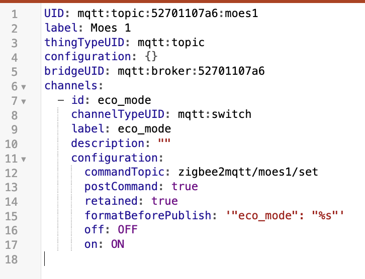

So, what you’ve missed is:
payload
{"eco_mode": NEW_VALUE}
You’re just sending ON/OFF
to the device, and it doesn’t know what to do with that…so it ignores it. There should be a message in the Z2M log saying as much.
eco_mode
from the incoming JSONPATH string, since eco_mode
doesn’t have its own state topic.{"eco_mode": %s}
{"eco_mode": "%s"}
Thank you! I tried your option
the message arrives but does not change the value in the device
it’s log file
Just try as command topic ‚zigbee2mqtt/moes1/set/eco_mode‘. As it is a switch you don‘t need an outgoing transformation.
Thank you!! It’s working !!
