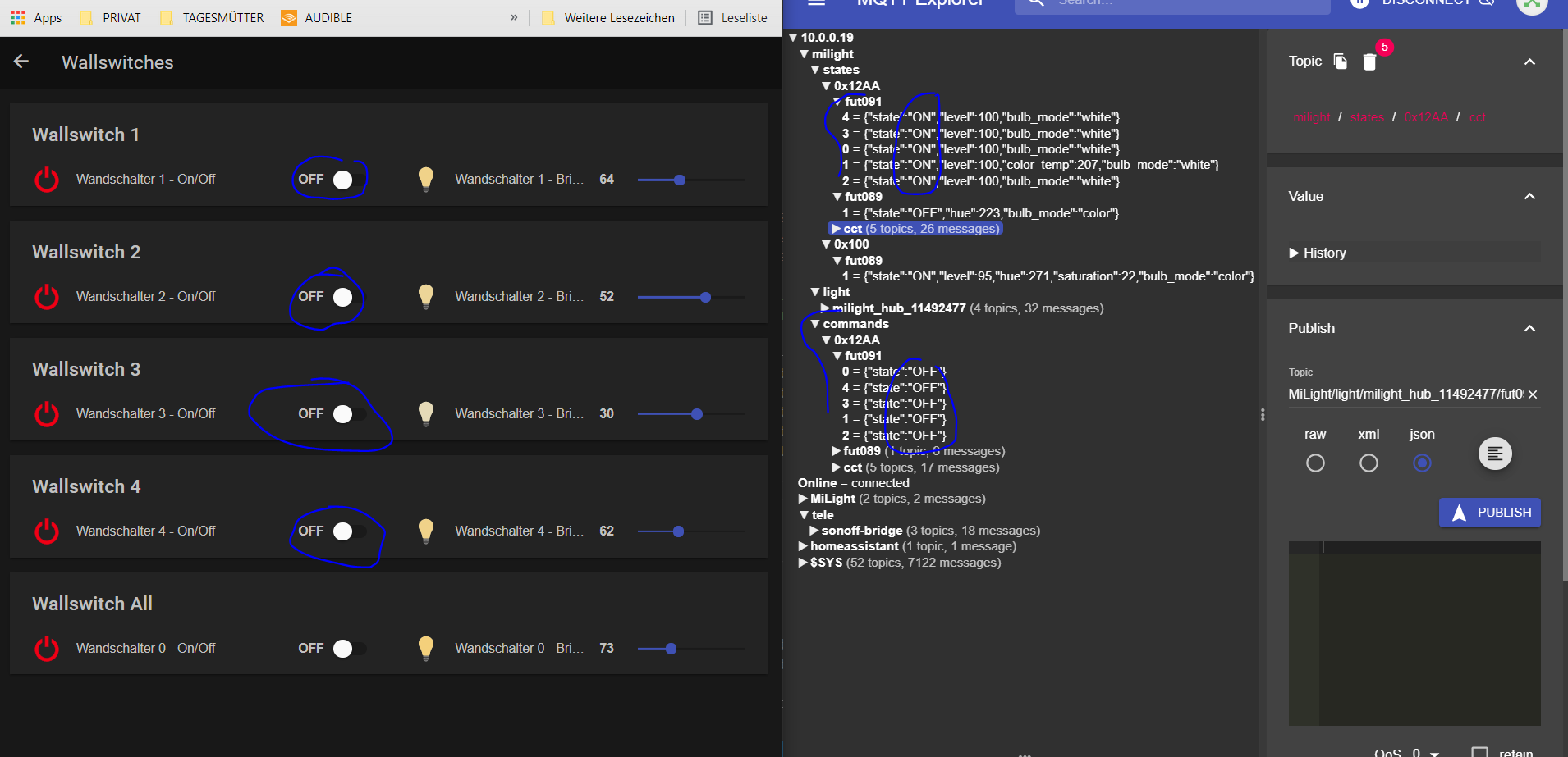

Ok. I made a big step forward tody but still not quite.
The MQTT status is not updated in openhab and in the status section in mqtt in case I change the values via a connected wall switch.
Out of Openhab all works fine.
Does anyone have an idea?
My Config:
Things:
Bridge mqtt:broker:MQTT “MQTT” [
host=“xx.xx.xx.xx”,
secure=false,
port=1883,
qos=0,
retain=false,
clientid=“openHAB-mqtt-bridge.things”,
keep_alive_time=30000,
reconnect_time=60000,
username=“xxxxxxxxxxxx”,
password=“xxxxxxxxxxx”
Bridge mqtt:broker:0x12AA “Milight Switches” [ host=“xx.xx.xx.x”, port=1883, secure=false, username=“xxxxn”, password=“xxxxxx”, qos=1]
    Thing mqtt:fut091:0x12AA0 "Test Switch" (mqtt:broker:0x12AA) @ "Home"
    Thing mqtt:fut091:0x12AA1 "Test Switch" (mqtt:broker:0x12AA) @ "Home"
    Thing mqtt:fut091:0x12AA2 "Test Switch" (mqtt:broker:0x12AA) @ "Home"
    Thing mqtt:fut091:0x12AA3 "Test Switch" (mqtt:broker:0x12AA) @ "Home"
    Thing mqtt:fut091:0x12AA4 "Test Switch" (mqtt:broker:0x12AA) @ "Home"
MyItems
Switch WallSwitch_1_LightSW “Wandschalter 1 - On/Off [%s]” (Bathroom,Lights) [“Switchable”] {channel=“mqtt:fut091:0x12AA1:level”}
Dimmer WallSwitch_1_LightLD “Wandschalter 1 - Brightness [%s]”(Bathroom,Lights) [“Lighting”] {channel=“mqtt:fut091:0x12AA1:level”}
Switch WallSwitch_2_LightSW “Wandschalter 2 - On/Off [%s]” (Bathroom,Lights) [“Switchable”] {channel=“mqtt:fut091:0x12AA2:level”}
Dimmer WallSwitch_2_LightLD “Wandschalter 2 - Brightness [%s]”(Bathroom,Lights) [“Lighting”] {channel=“mqtt:fut091:0x12AA2:level”}
Switch WallSwitch_3_LightSW “Wandschalter 3 - On/Off [%s]” (Bathroom,Lights) [“Switchable”] {channel=“mqtt:fut091:0x12AA3:level”}
Dimmer WallSwitch_3_LightLD “Wandschalter 3 - Brightness [%s]”(Bathroom,Lights) [“Lighting”] {channel=“mqtt:fut091:0x12AA3:level”}
Switch WallSwitch_4_LightSW “Wandschalter 4 - On/Off [%s]” (Bathroom,Lights) [“Switchable”] {channel=“mqtt:fut091:0x12AA4:level”}
Dimmer WallSwitch_4_LightLD “Wandschalter 4 - Brightness [%s]”(Bathroom,Lights) [“Lighting”] {channel=“mqtt:fut091:0x12AA4:level”}
Switch WallSwitch_0_LightSW “Wandschalter 0 - On/Off [%s]” (Bathroom,Lights) [“Switchable”] {channel=“mqtt:fut091:0x12AA0:level”}
Dimmer WallSwitch_0_LightLD “Wandschalter 0 - Brightness [%s]”(Bathroom,Lights) [“Lighting”] {channel=“mqtt:fut091:0x12AA0:level”}
Regards, Manuel
