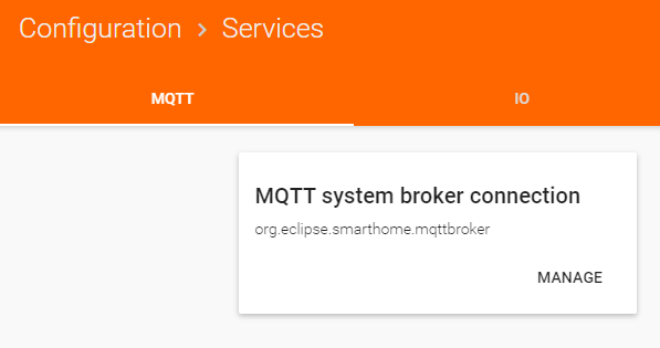

Do I have to use this?
Do you already have a broker installed?
If not, yes you would need a broker. I’m not sure which one is better. The built in (from your screenshot) or mosquitto. I’m using mosquitto and I’m quite happy with it
But anyhow, you need a broker :slight_smile:

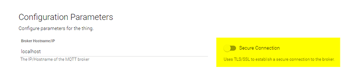

Since your broker thing is online, credentials seem to be ok. I’ve just tried to use wrong credentials and the thing immediately goes offline.
Are you using a secure connection?
If yes, try disabling it.
And also: Since the broker is running on the same machine, try “localhost” as the hostname/IP instead of the external IP of your NAS
You don’t want anything to do with the “system broker” stuff, when you are already using an independent broker (Mosquitto).

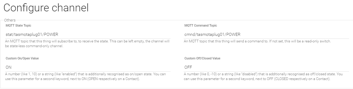

  4. Add in the Generic MQTT Thing a channel for every Tasmota plug:
  5. default.items
    Switch tasmotaplug01 “Steckdose Waschmaschine” {channel=“mqtt:topic:plugs:tasmotaplug01”}
