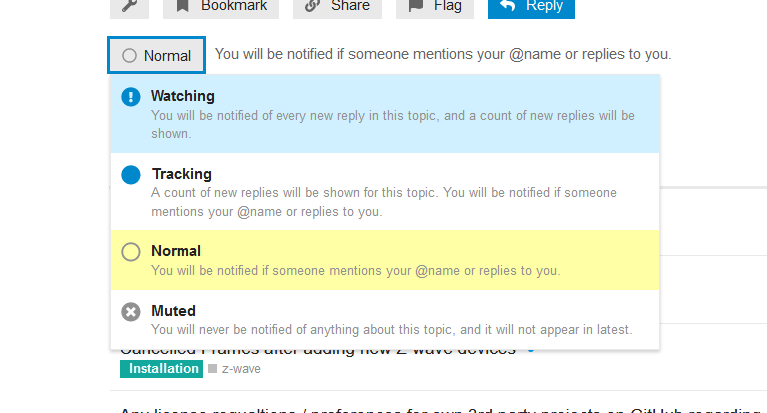

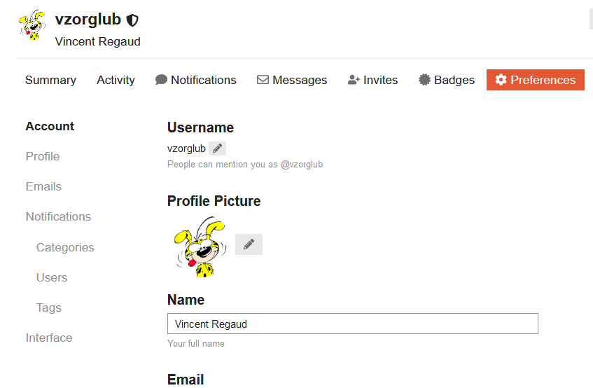

Edit: I can’t find any settings for e-mail notification, so I have to keep this open and check for replies manually. Aren’t e-mail notifications available here?
Yes they are:
You put your email address there:
Thanks @vzorglub - I just couldn’t find the preferences at first.
