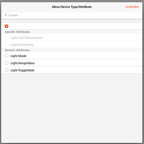

In the documentation (openHAB Skill For Amazon Alexa | openHAB) it says that a light works with following attributes: " Light Brightness Color ColorTemperature" but I can only find PowerState and ColorTemperature. Does anyone know if I broke something or if any of these other values is the right one?
Device attributes are based on item types. Could you provide details on what you are trying to configure?
I’m trying to configure my bathroom lights. I already tried to change it to Control-Light instead, but that didn’t help
Ok, I found the solution. It has to be a dimmer or colour to work with Alexa’s brightness. I had them all just as numbers.
