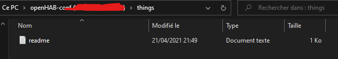

  • Issue of the topic: I can’t seem to be able to locate .things (or other) files. I was just trying to explore those files because I wanted to try rules with my alexa connected Light-Bulbs, but after looking around, there doesn’t seem to be any files like you would normally have

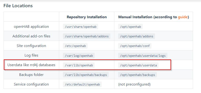

Tle location of userdata can vary depending on how OH is installed. In addition, a Docker installation opens up many more possibilities.
