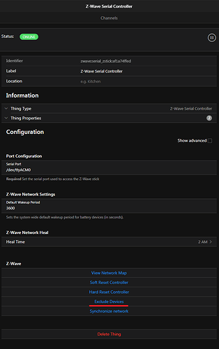

I have added most of my Zwave devices with the hard button on my Aeotec z-wave stick. I’m trying to secure include my door lock witch requires inclusion to be done from inside the controller. This would be fine except that I can’t find an include button anywhere in the UI, just an exclude one.
Am I missing it or is it missing?

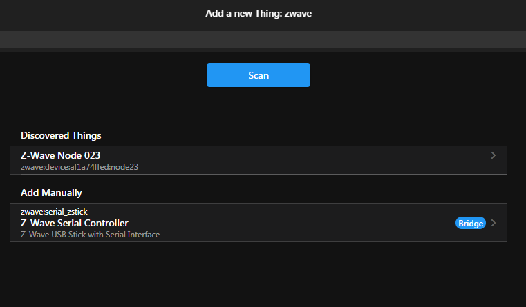

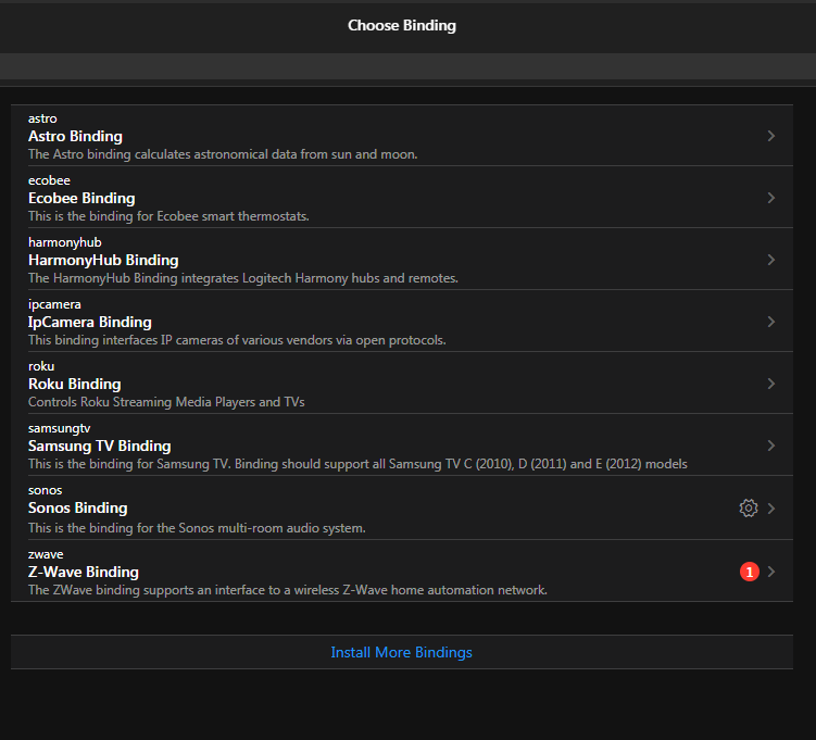

Goto the Inbox and click on the + (Plus) button.
And then click the Scan button. The device can only be included securely directly after a factory reset. The inclusion process must be completed within 15 seconds.
I’ve tried that but only see devices that have already been included.
Unless you are saying that it is in inclusion mode when I’m on one of these screens.
Your last screenshot shows the Scan button.
Saw your reply. Need some time to try it, but am going to. Thanks!
This totally did the trick. It’s a bit un-intuitive but easy enough once you got me there. Thanks to both of you for the help.
I agree it is unintuitive for the scan button to trigger network inclusion. Perhaps @chris can do something more intuitive in his system.
I don’t think this is something I can change - this is how openHAB works. To scan for devices, you click the scan button - it’s the same for all bindings.
