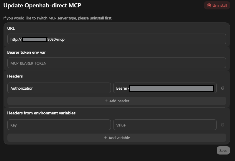

I was able to create a direct connection with my openhab server. The issue I was having was that I was entering the bearer token in teh bearer token env var. After consulting with Chatgpt, it instructed me to enter the token via the authorization header. I attached the screenshot for those wish to bypass the openhab cloud and create a direction connection.
