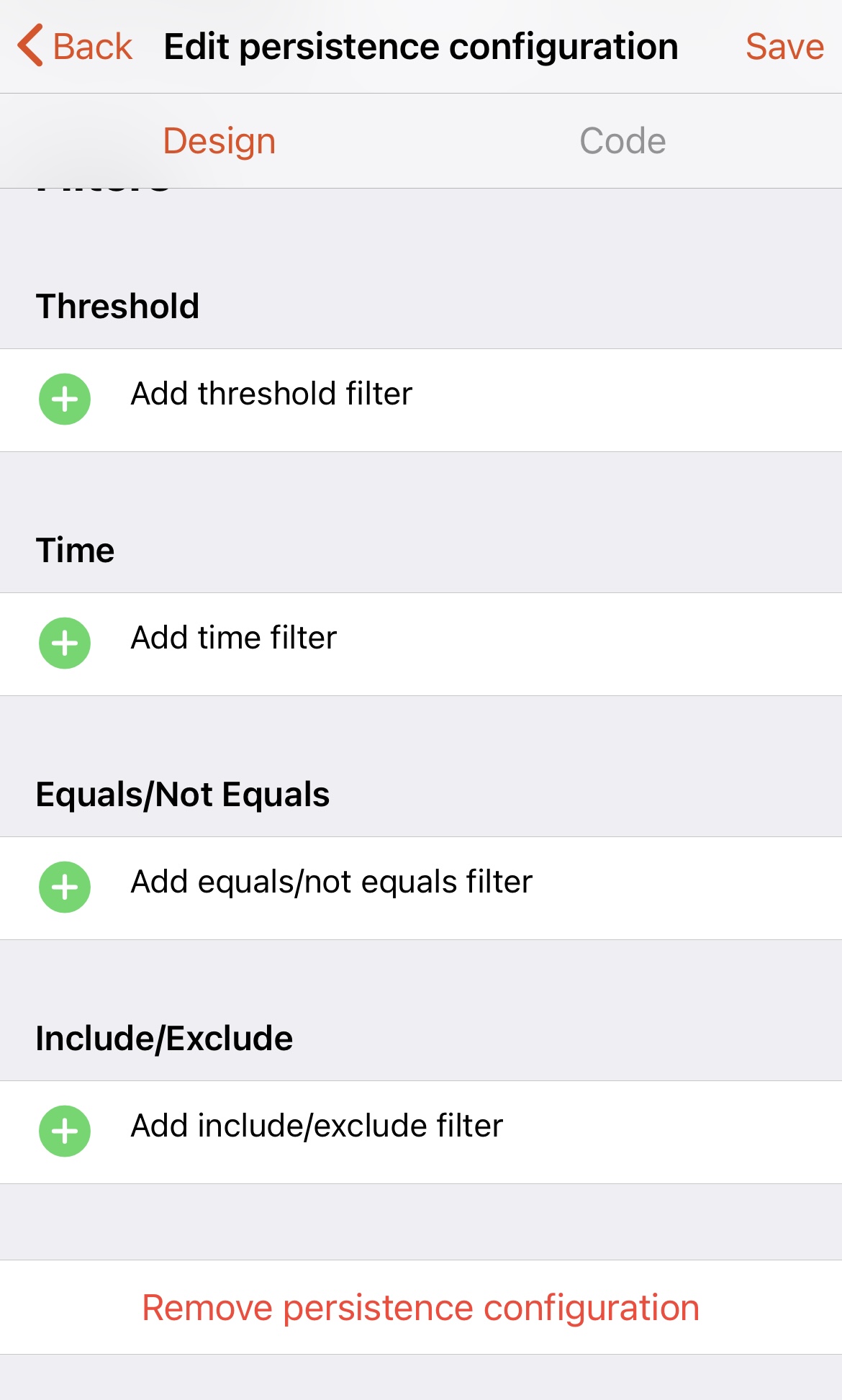

Without having tested this, but I guess deleting the RRD4J persistence configuration should have solved that. RRD4J didn’t persist anything, because you had a persistence configuration for it and that config did not include any Items. If there is no configuration for RRD4J, it persists everything (this is the state you restored by deleting the Persistence configuration JSONDB file).
If you have created a persistence config (the page display „Edit persistence configuration“ as heading), you have a remove button at the bottom of the page (the same as for all other UI stuff like Items):
