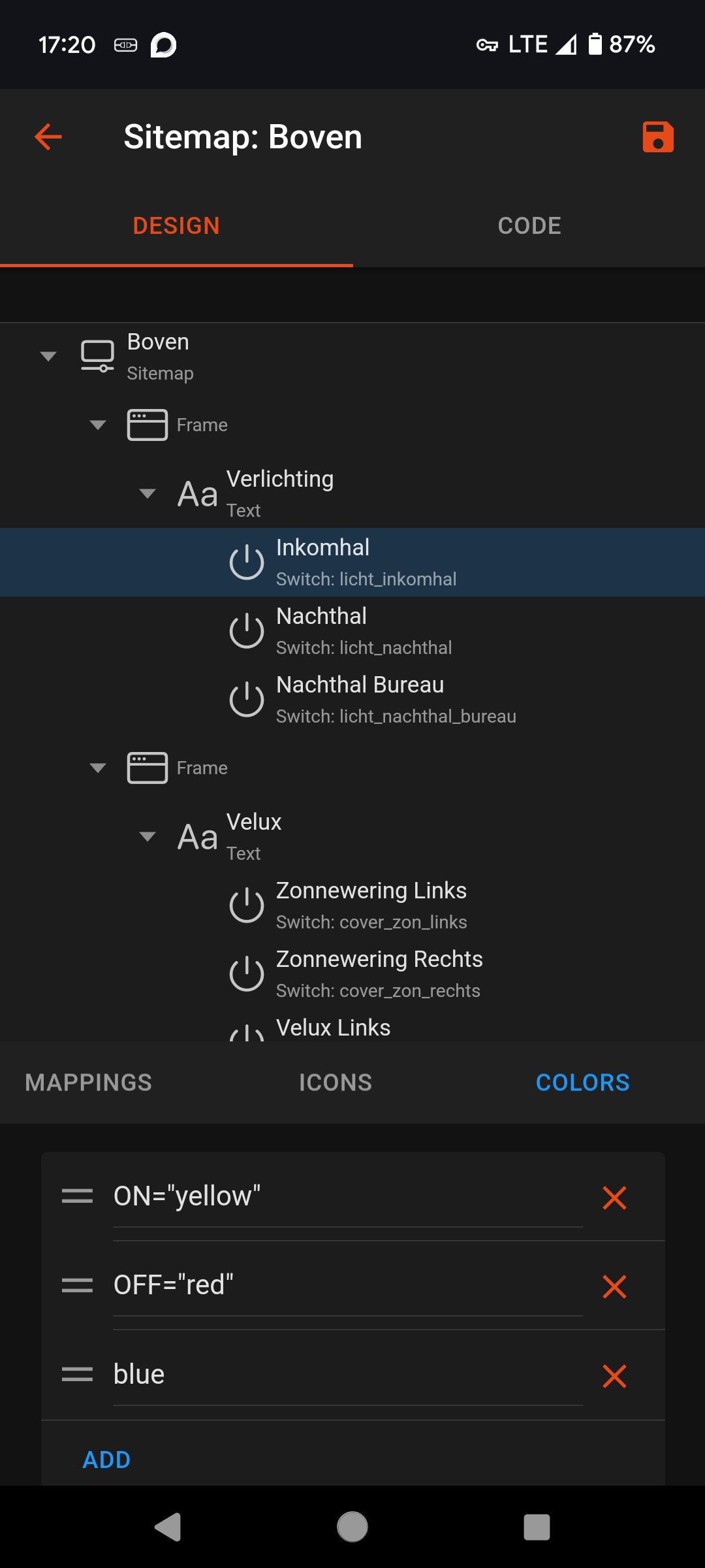

Hi, since a few days runing OpenHabn using basicUI , but cant get iconcolor to work
If i use the classic icon “lightbulb”, when turning on/off light, i see it changing to yellow…
But i want to have iconify or material design icons, for some reason, i cant get it to work, as for test, the icon is always “blue”
the states are correct, the mappings also work; ponly icon color doesnt…
2024-10-26 16:04:36.970 [INFO ] [openhab.event.ItemStateChangedEvent ] - Item 'licht_inkomhal' changed from OFF to ON
2024-10-26 16:04:39.029 [INFO ] [openhab.event.ItemStateChangedEvent ] - Item 'licht_inkomhal' changed from ON to OFF

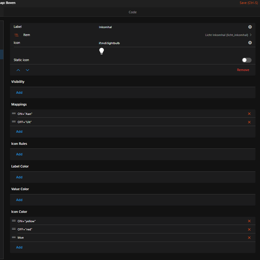

            Switch icon=if:mdi:lightbulb item=licht_inkomhal label="Inkomhal" mappings=[ON="Aan", OFF="Uit"] iconcolor=[ON="yellow", OFF="red", "blue"]
Wht am i missing?
also tried like
"ON"="yellow" instead of ON="yellow"

Aha, that’s something to try , gonna test tomorrow!!
Ok , now it’s working indeed, strange , it’s also documented that it should work without the itemname specified?
I will investigate. It is supposed to work without specifying the item. Maybe the presence of “mappings” is the cause.
Please try without mappings to confirm that only this case is concerned.
I also tried without mappings, didn’t work either :frowning:
it seems for a rollershutter item i dont need to add item, it works like this:
only for lightbulb i need to add the item?

What I notice , if you look on code, the first one doesn’t work, the second one works, where I included the itemname…
Below is the json, I also use mappings, for the mappings it adds \ \ in the strings, while it doesn’t for the iconcolor…
Maybe that’s the issue?
As mentioned in the other topic, this is certainly a bug in sitemap generator (Main UI) only.

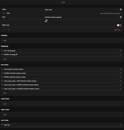

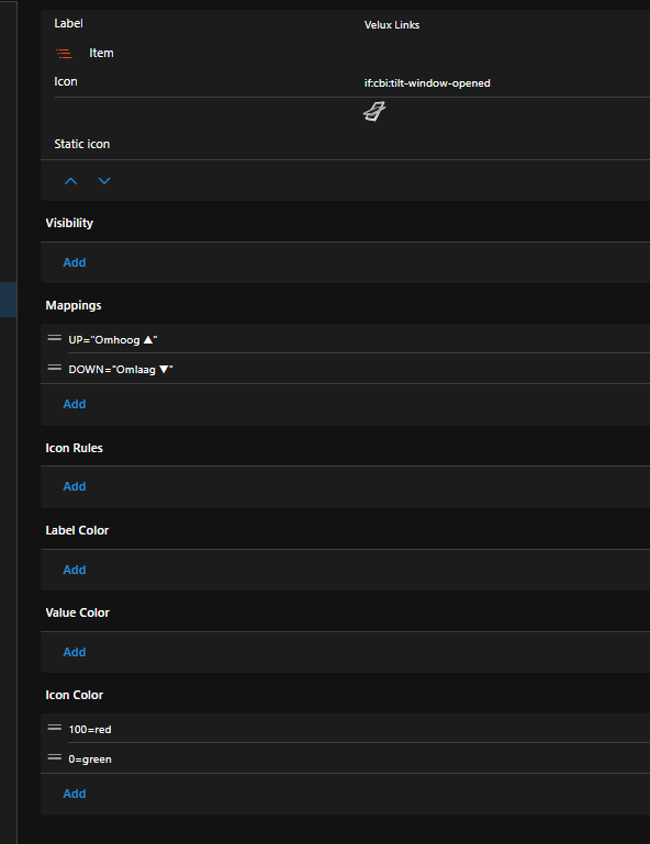

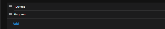

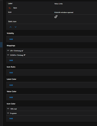

what about rollershutter icon rukes? it works like below (for color), then no itemname is needed:

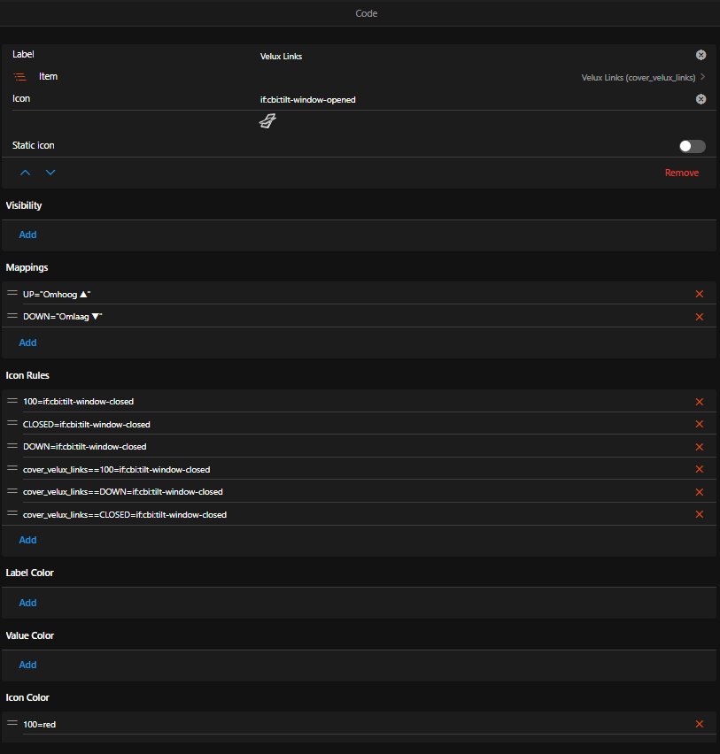

for icon rules, i cant get it to work? what am i missing here?, its always displaying the default icon, … the color works, its showing “red” , but icon is always “if:cbi:tilt-window-opened”
can you test it with code? i dont use the code now, maybe its a bug too, and i can stop testing …

Please check your quotation marks, you have set them wrong!
I tried both , but it’s the same
What if you remove the blue ???
Then the color doesn’t change at all, it stays default white
If you look a few posts back, I have also mappings defined, in the code i see like ON="xx"
Maybe I need to include those backslash too in the code?
