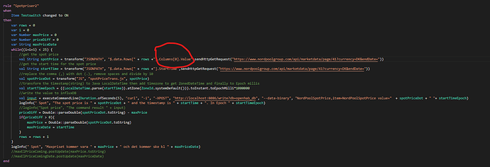

Hi
Its working when i use the swedish “https://www.nordpoolgroup.com/api/marketdata/page/29?currency=SEK”
but when i tried the danish “https://www.nordpoolgroup.com/api/marketdata/page/41?currency=DK”
i get this error
2022-04-08 06:26:11.427 [ERROR] [internal.handler.ScriptActionHandler] - Script execution of rule with UID 'Nordpool-2' failed: Character N is neither a decimal digit number, decimal point, nor "e" notation exponential mark. in Nordpool

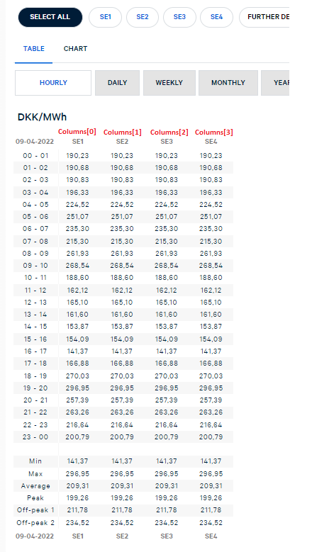

Ok figured it :slight_smile:
This line needed to be changed to fit the Danish api page, there only 2 columns available.
 String spotPrice = transform("JSONPATH", "$.data.Rows[" + rows +"].Columns[0].Value",sendHttpGetRequest("https://www.nordpoolgroup.com/api/marketdata/page/41?currency=DK&endDate="))
This where the changed is needed
The Swedish api page has 4 columns (this is the NORD POOL DAY-AHEAD for Sweden)

        val startTimeEpoch = ((LocalDateTime.parse(startTime)).atZone(ZoneId.systemDefault())).toInstant.toEpochMilli*1000000
        // Write the value to influxDB
        //val input = executeCommandLine(Duration.ofSeconds(5), "curl", "-i", "-XPOST", "http://localhost:8086/write?db=openhab_db", "--data-binary", "NordPoolSpotPrice,item=NordPoolSpotPrice value="  + spotPriceDot + " "+ startTimeEpoch)
        logInfo("ElspotRule", "The spot price is " + spotPriceDot + " and the timestamp is " + startTime + ". In Epoch " + startTimeEpoch)
        //logInfo("ElspotRule", "The command result " + input)
        priceDiff = Double::parseDouble(spotPriceDot.toString) - maxPrice
        if(priceDiff > 0){
            maxPrice = Double::parseDouble(spotPriceDot.toString)
            maxPriceDate = startTime
        // Add price to arraylist
        spotPrices.add(Double::parseDouble(spotPriceDot.toString))
        rows = rows + 1
	// Update arraylist with pricelevels, 1 to 3 where 3 is highest price
    var int j = 0
    for (double x : spotPrices) {
    	var double max = Collections.max(spotPrices)
        // Set price level to 3 for the eight most expensive hours or if price > 4.0 SEK/kWh
        if(j < 8 || max > 400.0 ) {
        	spotPriceLevel.set(spotPrices.indexOf(max), 3)
        // Set price level to 1 for the three cheapest hours or if price is less than 0.6 SEK/kWh
        else if(j > 20 || max < 60.0) {
        	spotPriceLevel.set(spotPrices.indexOf(max), 1)
        else {
        	spotPriceLevel.set(spotPrices.indexOf(max), 2)
        spotPrices.set(spotPrices.indexOf(max), -1.0)
        j = j + 1
    logInfo("ElspotRule", "spotPriceLevel " + spotPriceLevel.toString())
    logInfo("ElspotRule", "Maxpriset kommer vara " + maxPrice + " och det kommer att inträffa kl " + maxPriceDate)
