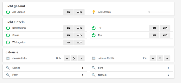

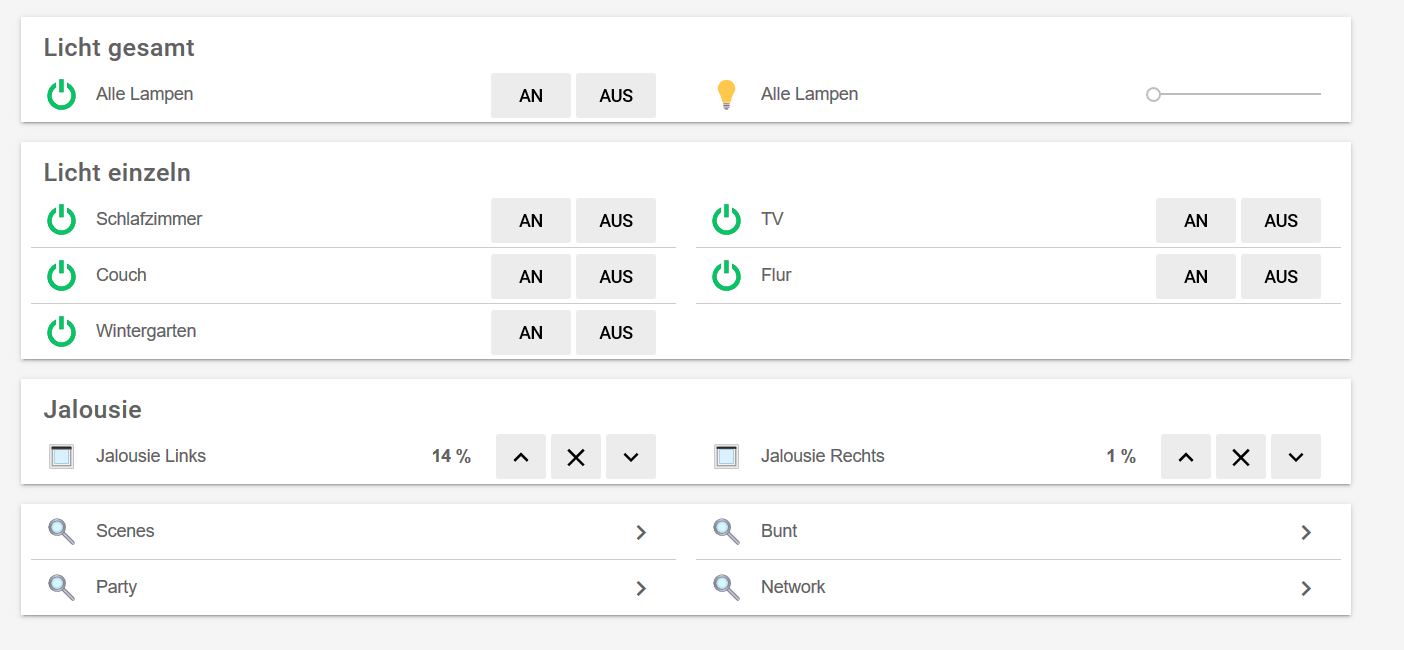

Actually I’m not sure how to interpret these exceptions. What I see is that obviously the saved state is obviously only partly read from the database:
As you can see the buttons don’t have a state, but the Rollershutters (Jalousie) get their state after about 30-60 sek.
