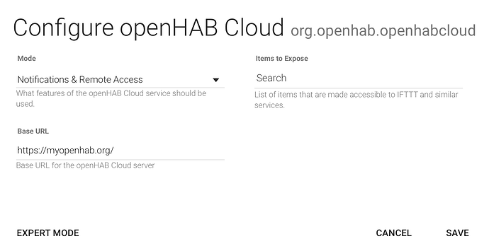

This is how I have openHAB Cloud configured within the paper UI - is this all correct?
Not with notifications, but you should see it connecting to the cloud server.
2019-10-22 10:08:08.705 [INFO ] [io.openhabcloud.internal.CloudClient] - Connected to the openHAB Cloud service (UUID =...
Search for/grep for log lines containing “CloudClient” and you should see if your OH is having difficulty connecting to the server.
I see, and yes I do have a log entry much like your example which shows that it has connected. This entry happened the last time I edited the config for openHab Cloud.
