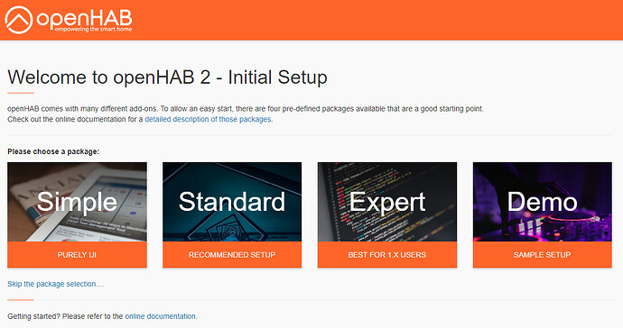

Must hijack this as i can`t make a new topic ! I to have problems installed on a headless pi. that seems to go good but in browser pirefox i go to
http://openhabianpi:8080/start/index
Nice page,there is choose a packet nothing happens ! on the skip package selection only a # come in the browser adress nothing else .

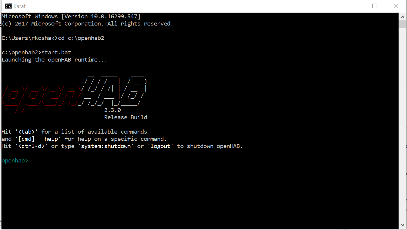

I just went through the steps on my Windows machine:
  1. My system already has Oracle Java 8 installed
  2. Added JAVA_HOME to my environment variables
  3. Downloaded the 2.3 R Manual Distro
  4. Extracted the zip file to C:\openhab2
  5. Ran start.bat
So unless you want to learn how the .bat file works, I think your time would be better spent looking at the list above for the source of your problem.
