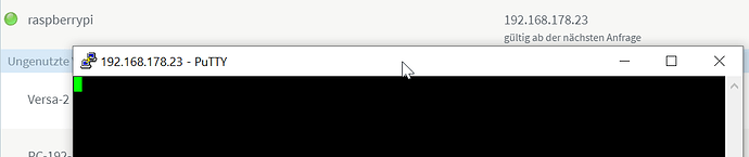

But I can’t seem to find the openhab-raspi in my network. This is the closest I can find but using Putty with this IP just gives me a blank screen:
Looks like it doesn’t connect to my network or something is totally messed up. Do you have an idea what I could do/test before I have to setup everything from scratch again?
Try to login via keyboard and using a monitor.
If that does not work in case of a lost password you could mount the linux partition of the SD card to an other linux system and edit the file shadow which contains the encrypted password for the related account.
