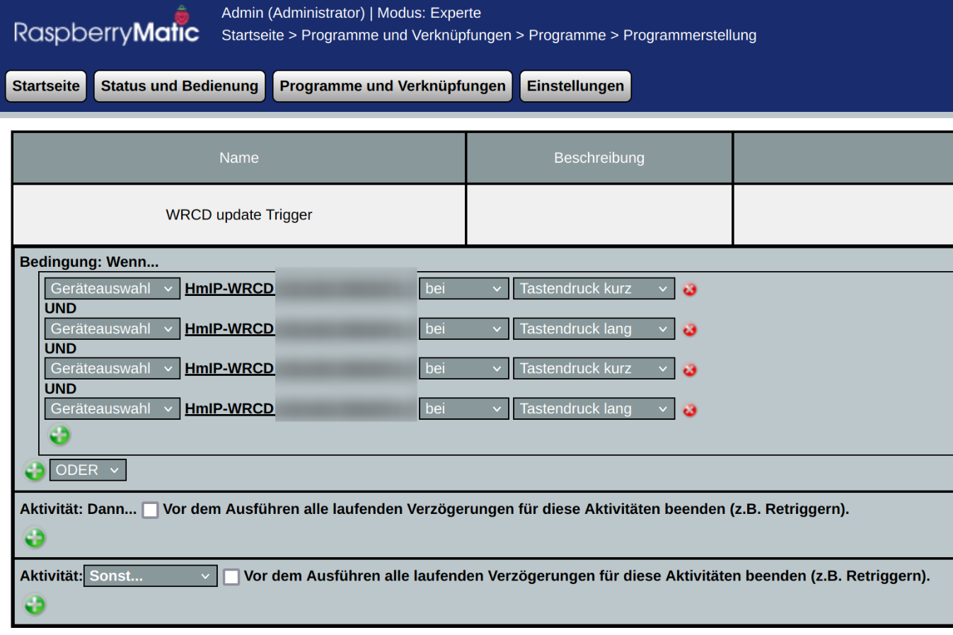

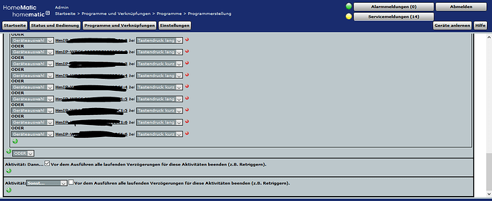

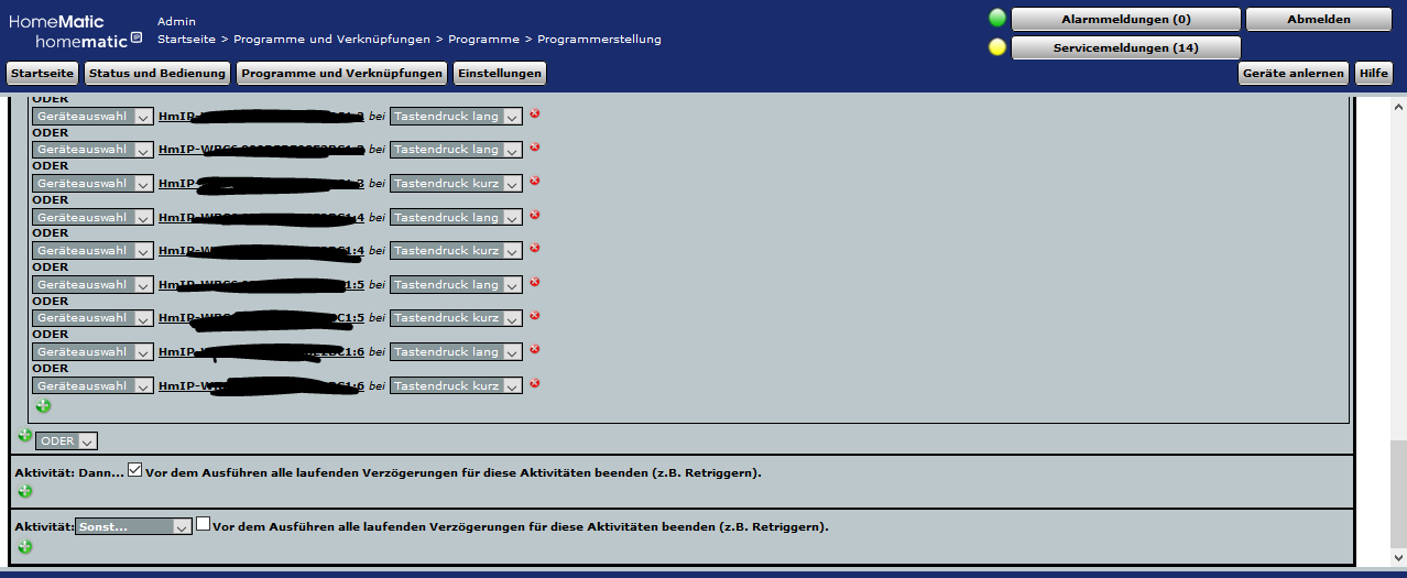

I found a solution. You have to set programs in the CCU for triggers. The programs can be totally senseless, but have to resume the button you want to transmit to openhab. Without the programmes the trigger won’t work in openhab.

Hello, it looks facing exactly the same issue with HmIP-WRCC2. As not been experienced in using the CCU so far, can you share an example senseless programm making the channel usable in Openhab?.
this is unbelievable, after adding this in the ccu rules or programm my itmes worked immediately.
Thsi can’t be a feature - anyhow you made my day!

Unfortunately this didn’t solve the Problem for me. After I added the rules a could at least see the correct button triggers in the CCU protocoll.
But the trigger doesn’t seem to get sent to the OH Interface.
Works great, searched around and was very frustrated that I could not find anything in any log of openHAB. But, right now it is fairly clear that the issue is constructed by the CCU3.

This saved my day. I edited a dummy-program as described in the screenshot above, and so openHAB recognized my Homematic IP-Switch.

Hi, strange, but this was really the solution. No button updates received on openHAB 4.2.1 and CCU3, but added just some empty program doing nothing forwards the events to openHAB. Thanks for this tip.

Hi, thank you @Christian_Hartmann!
It works with my openhab2 instantly.
